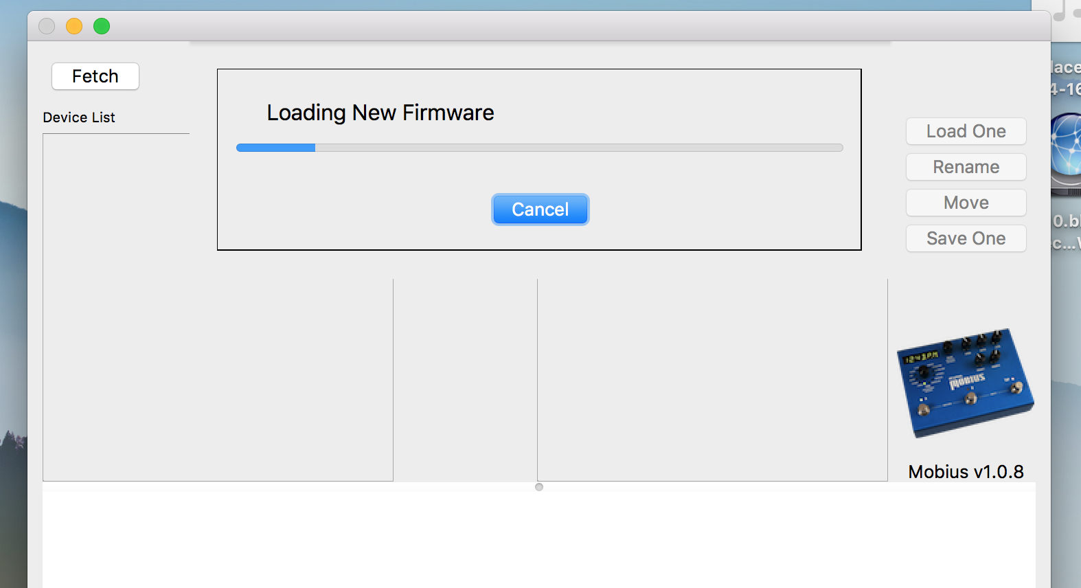

Annnd....I bought a 1/1 USB to MIDI cable to use with the Strymon editors and it doesn't fucking work. :mad:
