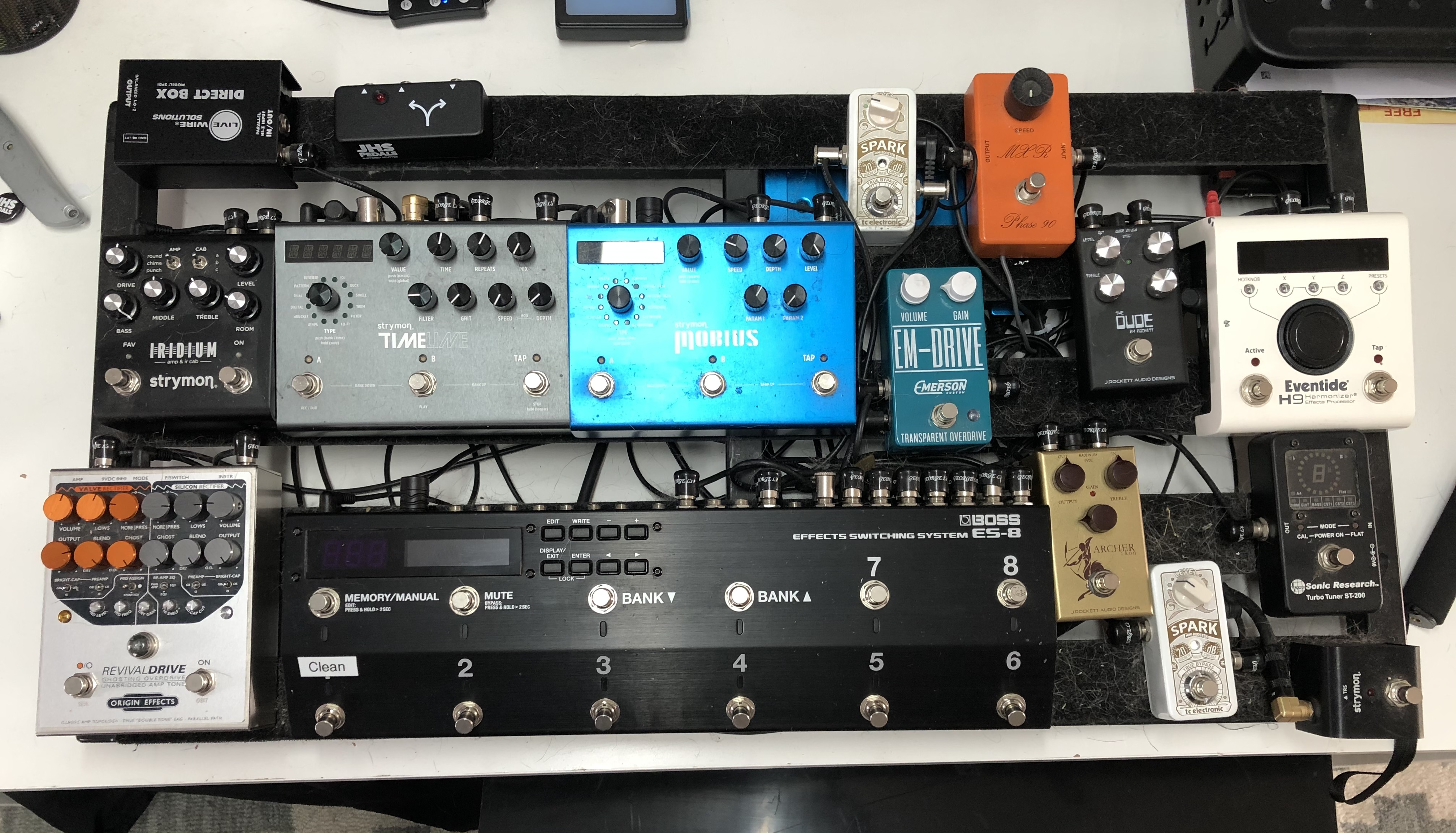

One way of doing this is really look at the order you are putting it together so you have shorter cable runs if that ES-8 is a patch bay. Maybe 2 tier your board for a cleaner look.

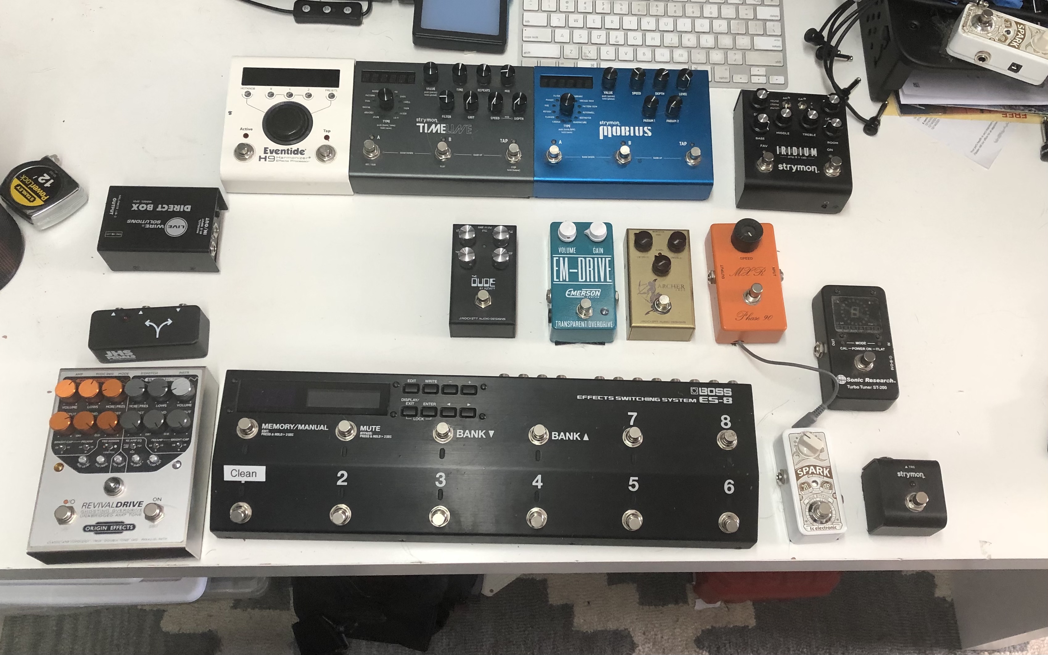

Yeah. I need to sit and make an actual inventory but it’s probably about 50 or so ends that I’ll need:
I’m going to build a shelf or riser for the midi stuff since none of it really can lay on a flat surface with the way that midi cables work on those devices.

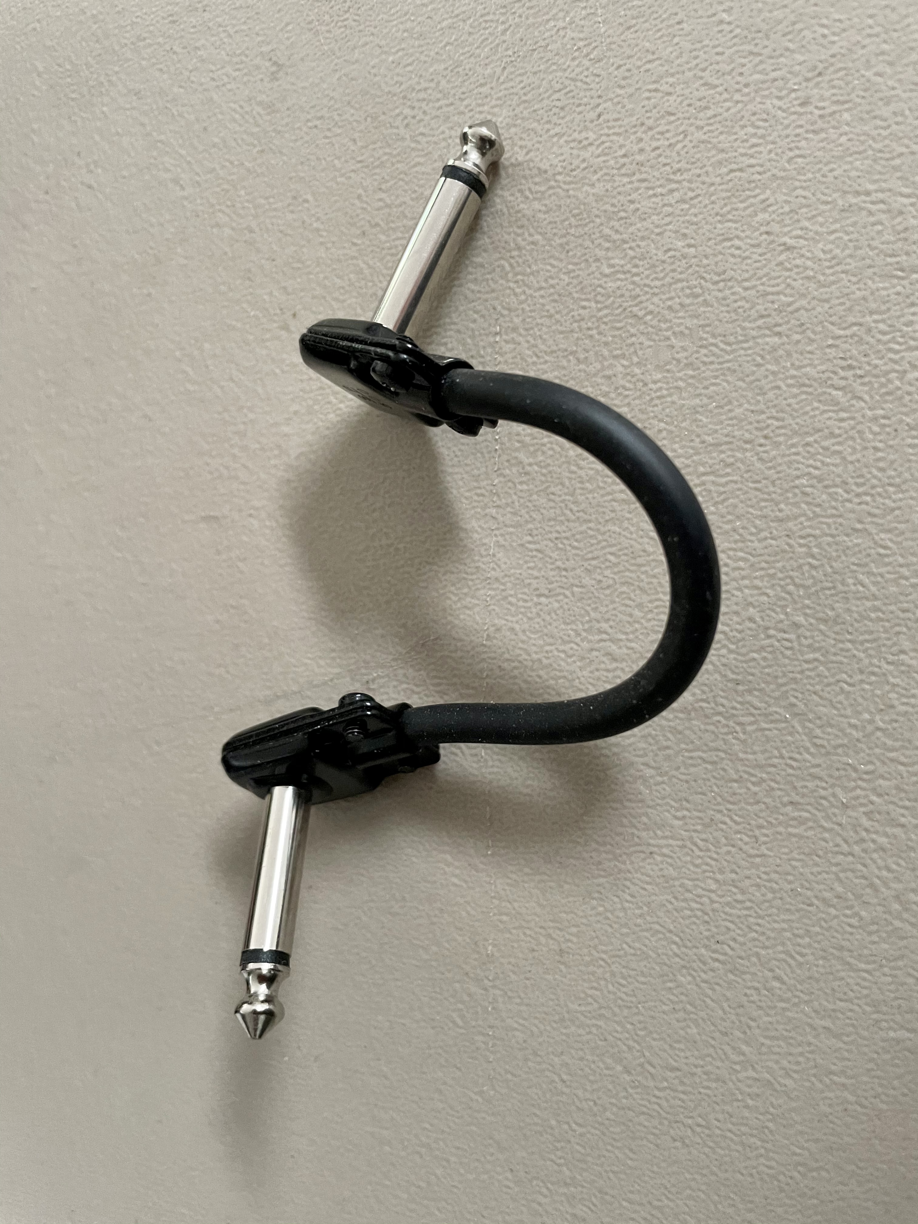

After years of making my own cables, I went with the Ernie Ball Ribbon.
Why give up on the Geo L's if you have so many ends already?
the biggest issue is the rats nest coming out of the ES-8 - the I/O section doesn’t work well with the
George L 45 degree ends.
