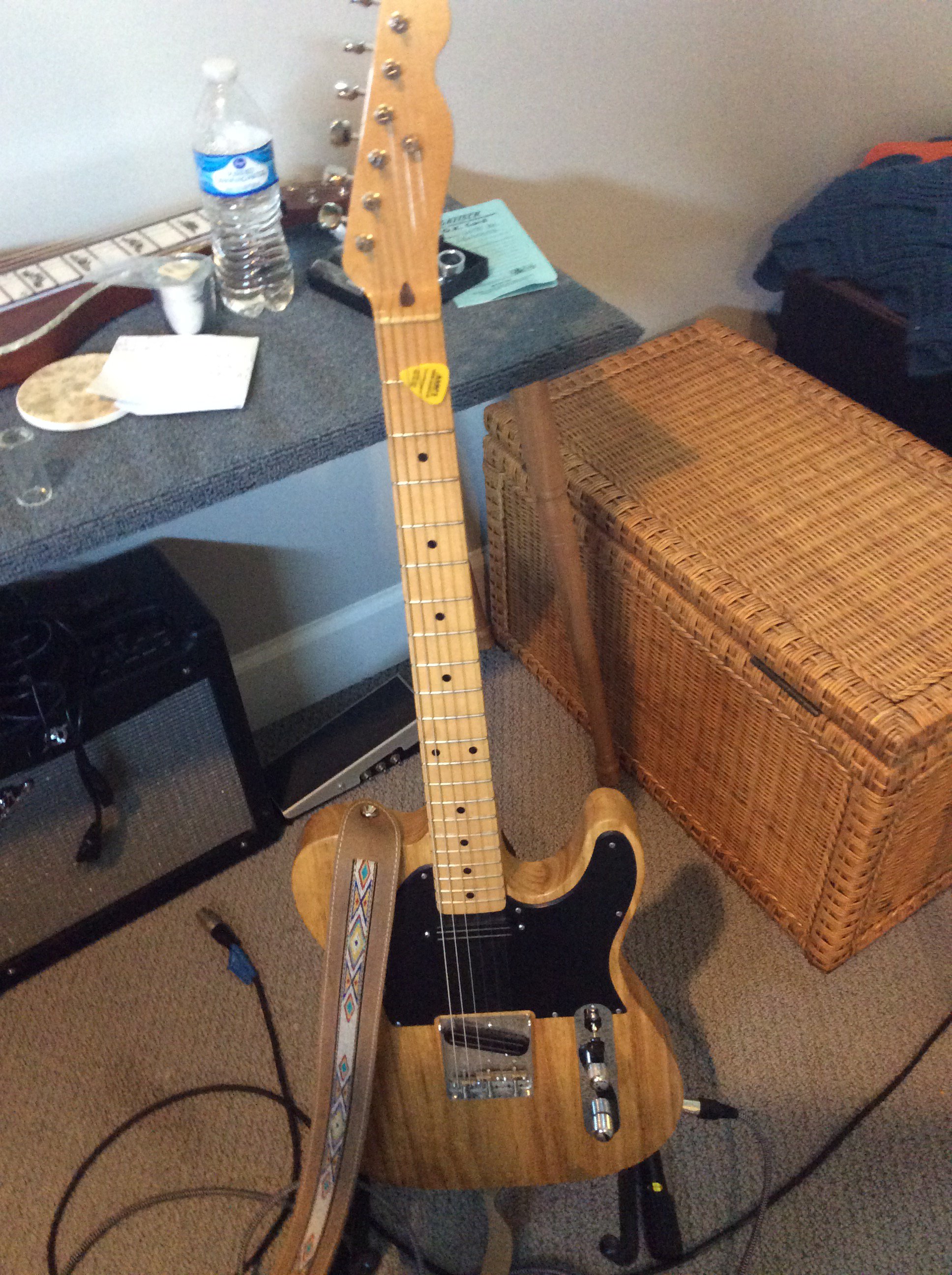

This one is my fav. Allparts TMO fat neck in nitro, Shellacked Pawlonia body, Bill n Becky L45s and L48TL pickups. Hardware is just standard aftermarket stuff.

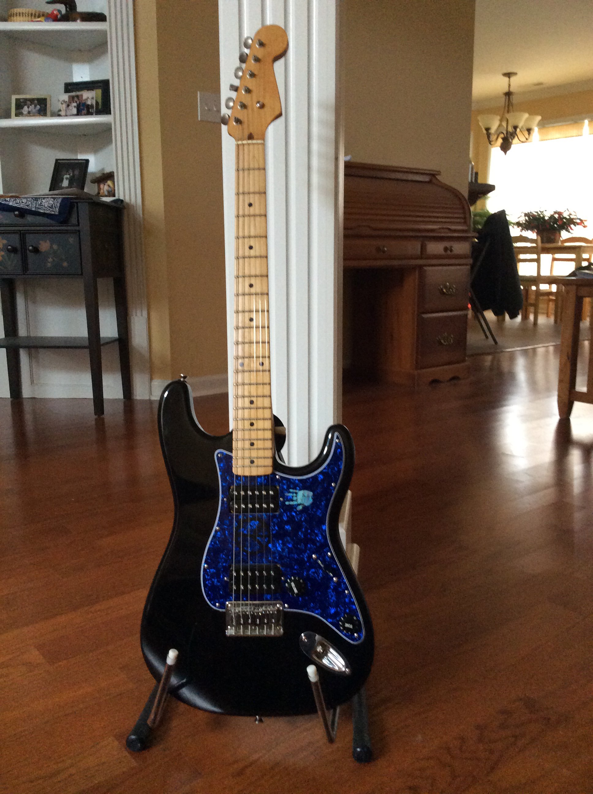

This ones an Allparts neck I got from Modern Saint, a hardtail Squier body, and Dragonfire pickups.

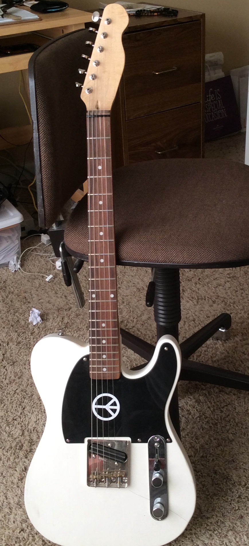

This is a GFS neck and pickup, cheap pine body off eBay. Bins white finish. It needs some nut work but I'm too cheap to buy files. Did the best I could with welding tips. I don't care much for the pickup either.
