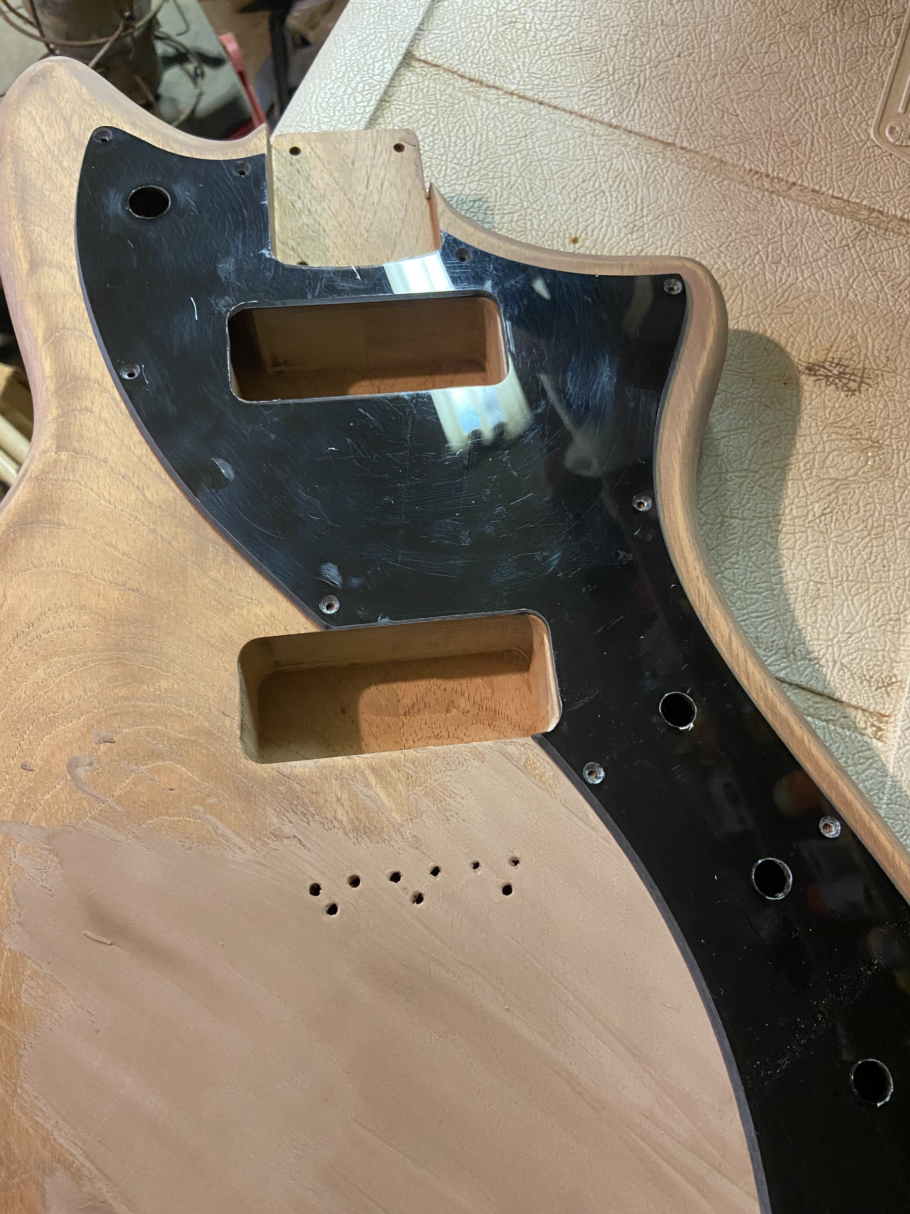

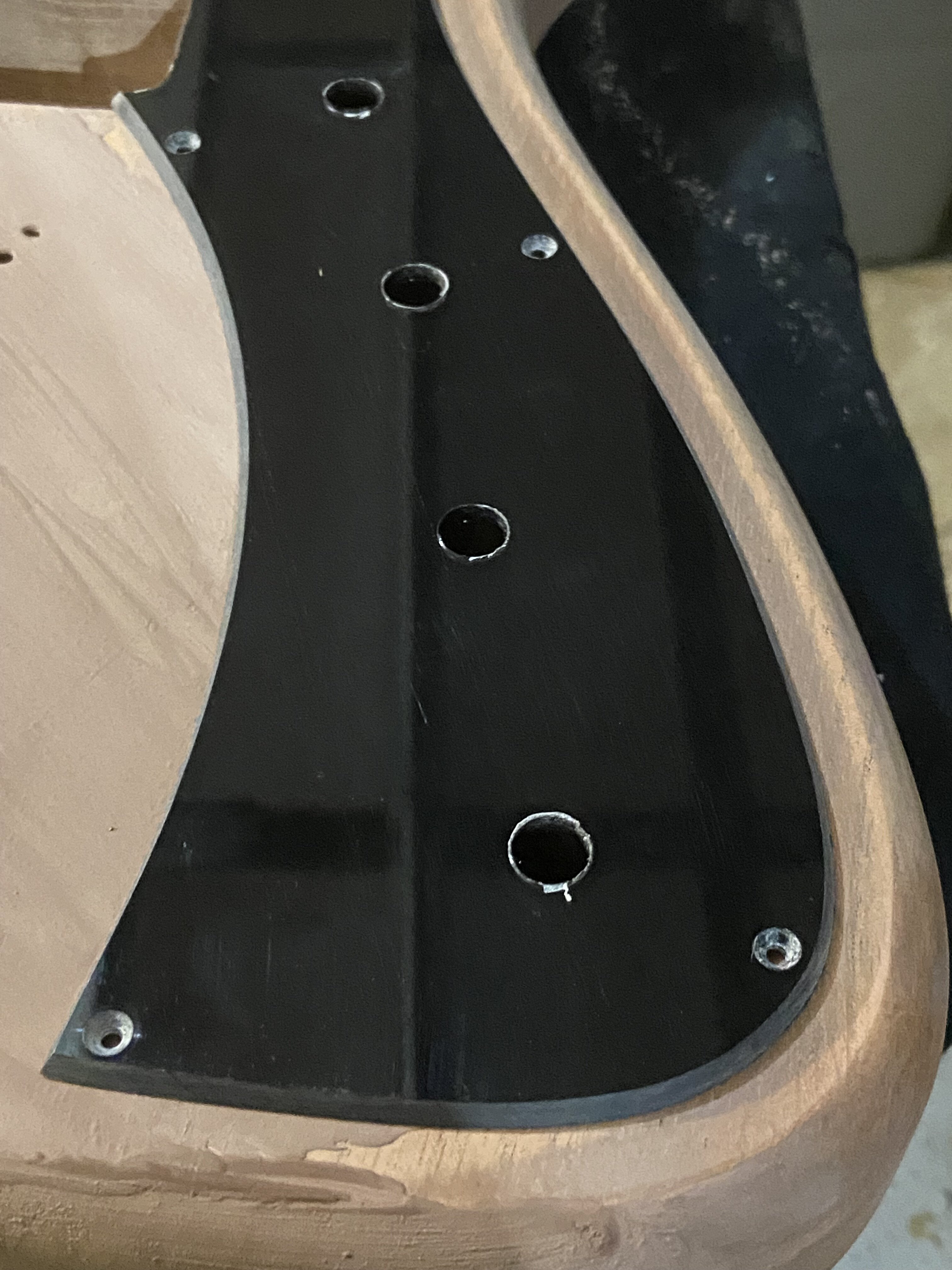

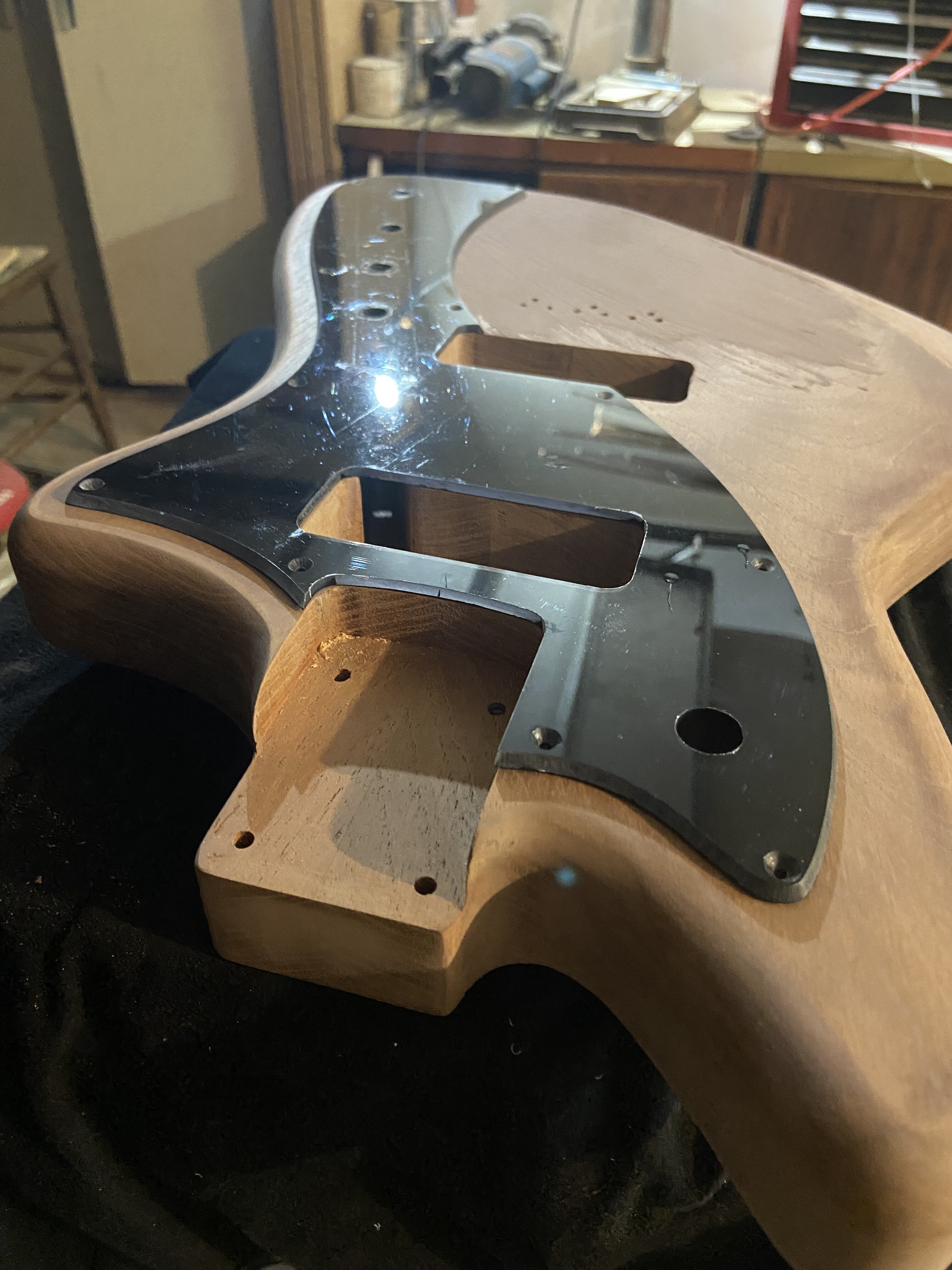

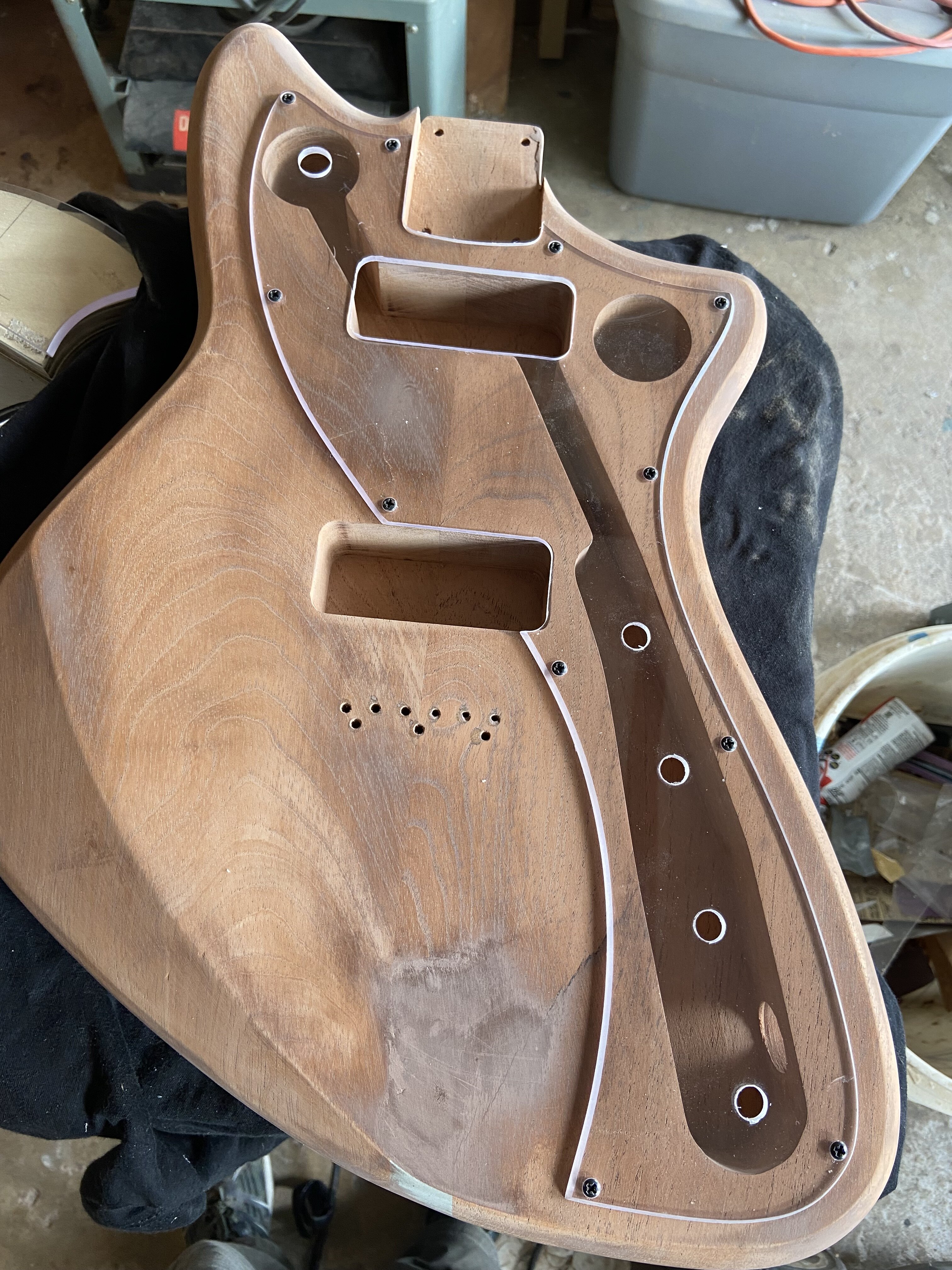

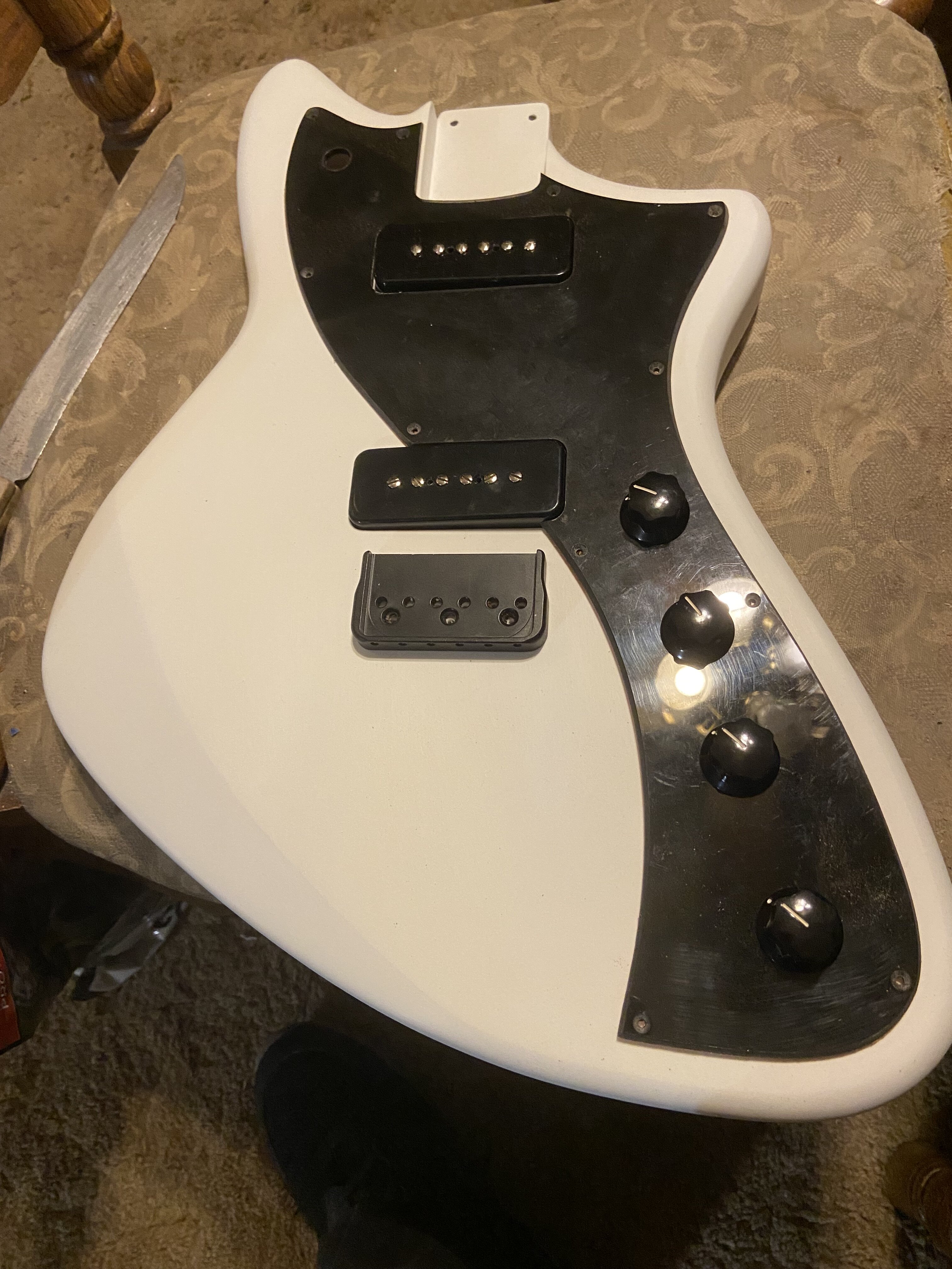

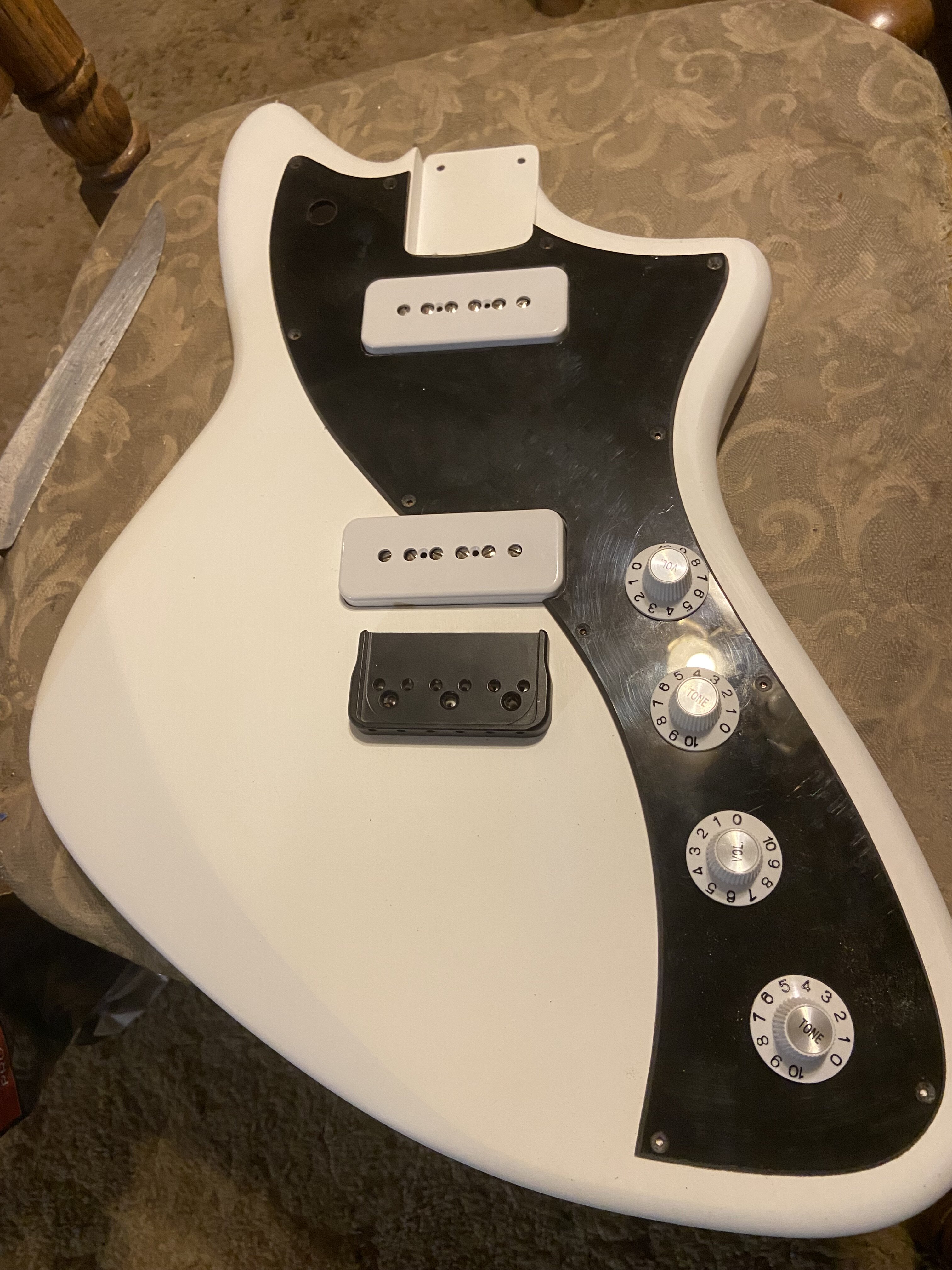

Well, I boofed the pickguard on SN3. I now know that BWB three ply pickguard material does indeed have a front and back side.
I don’t have any BWB material on hand but I do have more polycarbonate like I used on SN1….so imma spray it black from the back side.
That looks killer!

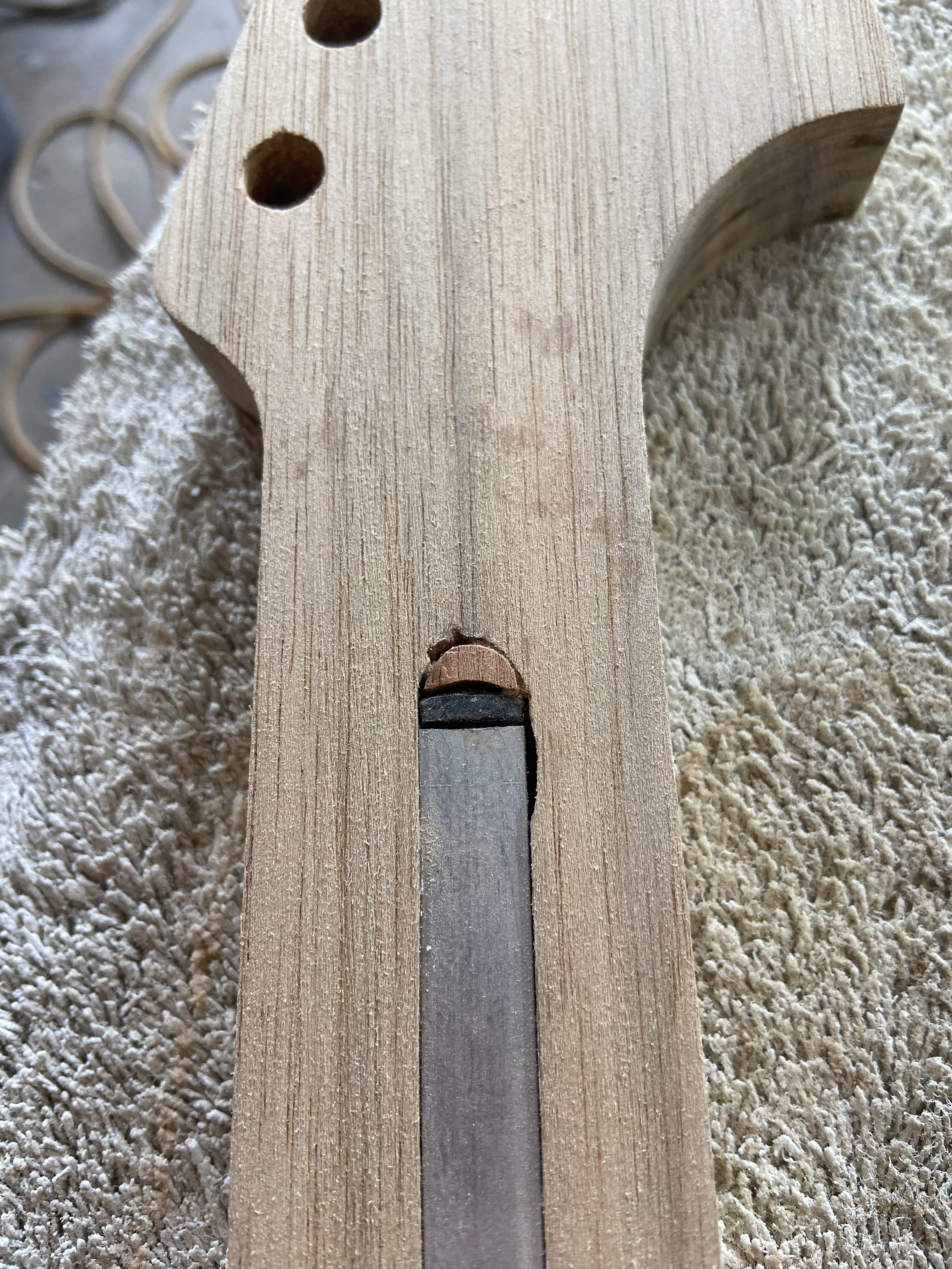

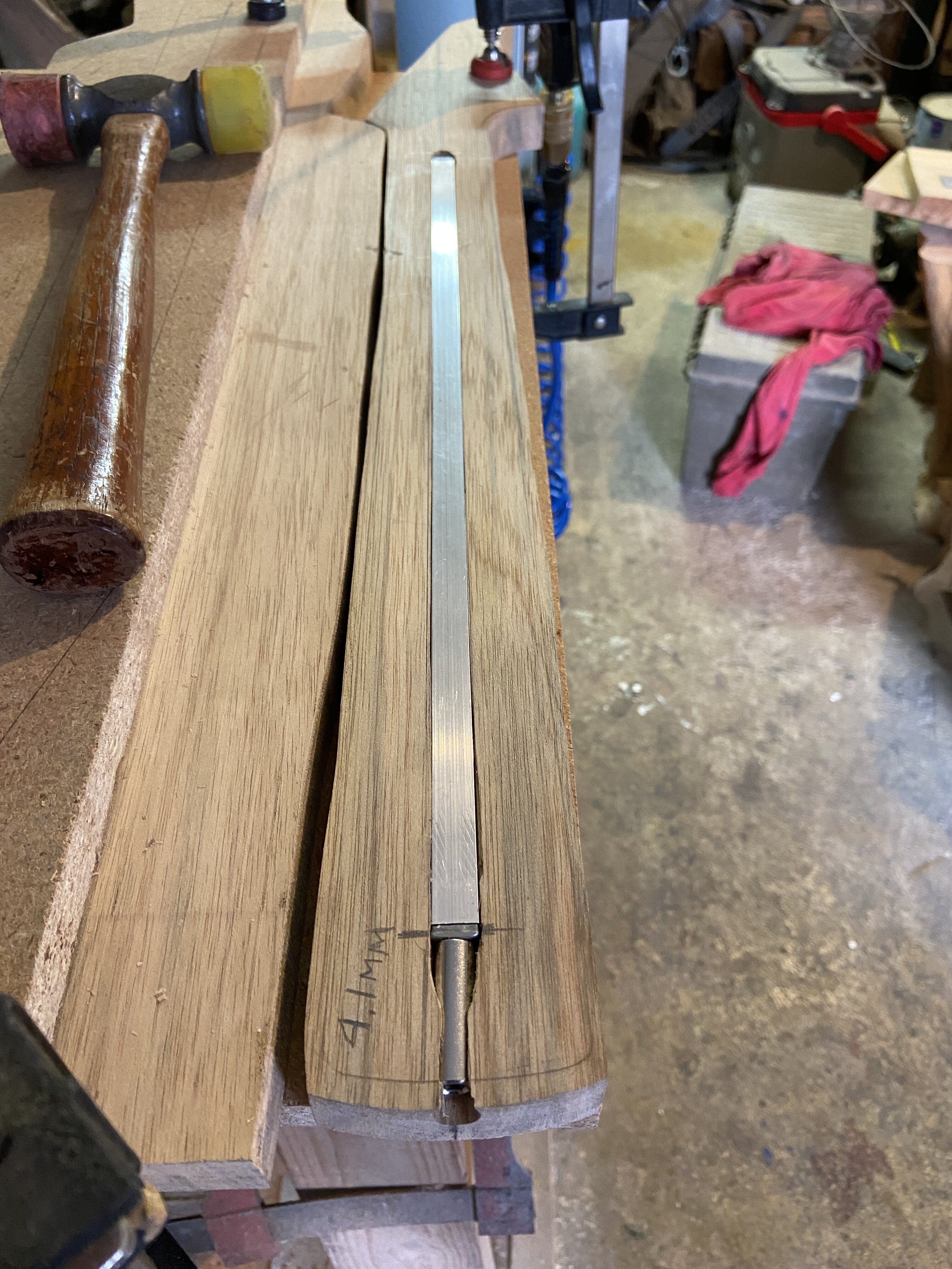

Time to turn to a little neck construction. Tru-oil is drying on SN1 while SN2 and 3 are on hold because it’s too wet to spray lacquer.

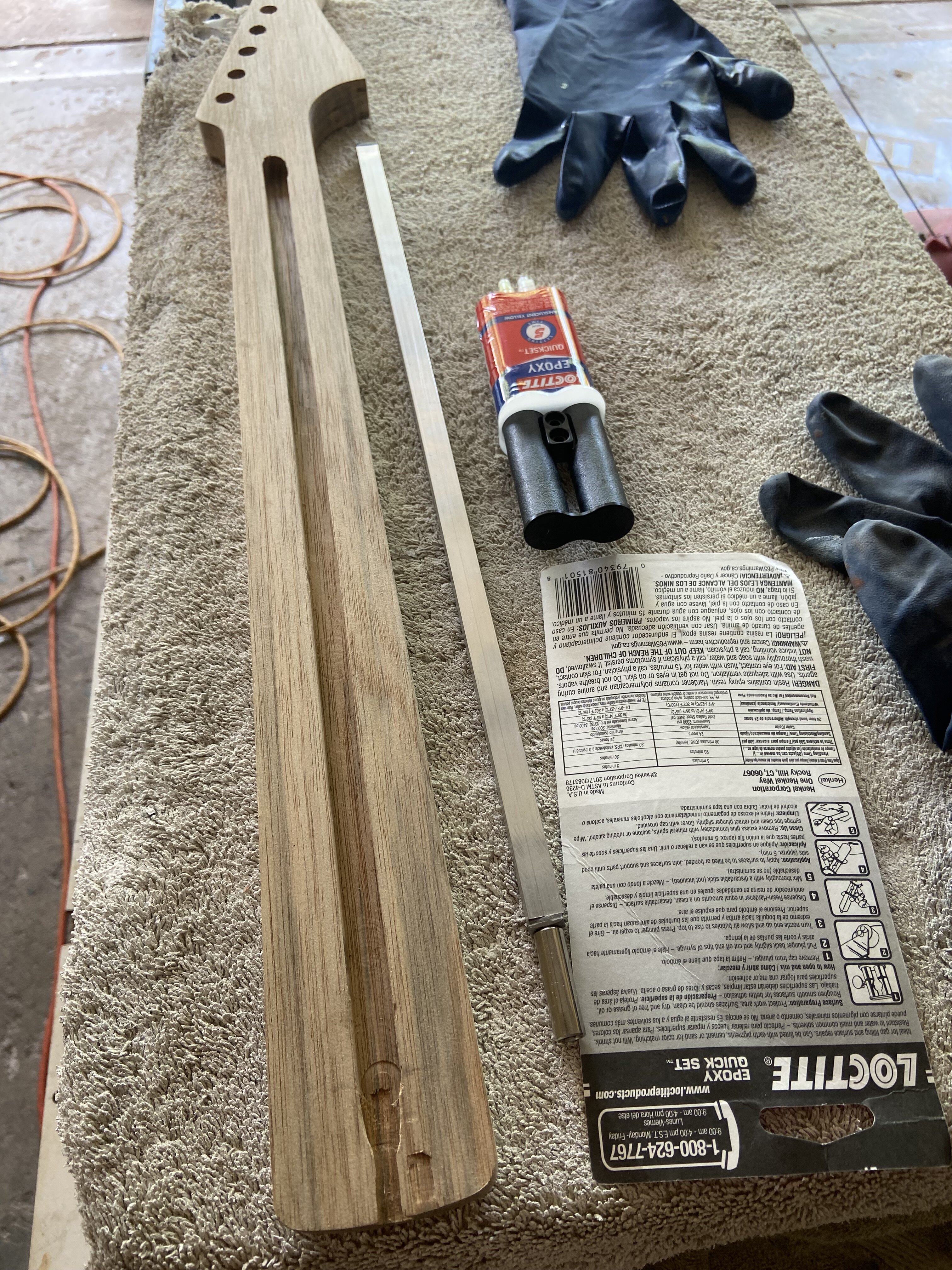

Here’s what I got. One chunk of well-aged African mahogany with some gray mineral streaking. One truss rod. One slice of wenge to serve as a fingerboard. I have fret wire around here somewhere. Some Jescar medium jumbo I believe.
The mineral streaking is subtle but pervasive and runs throughout. I guess this makes my neck appropriate for hard rock music.
I’m digging the wenge. It’s freaking hard and has a nice glass-like quality to the sound when you rap on it.

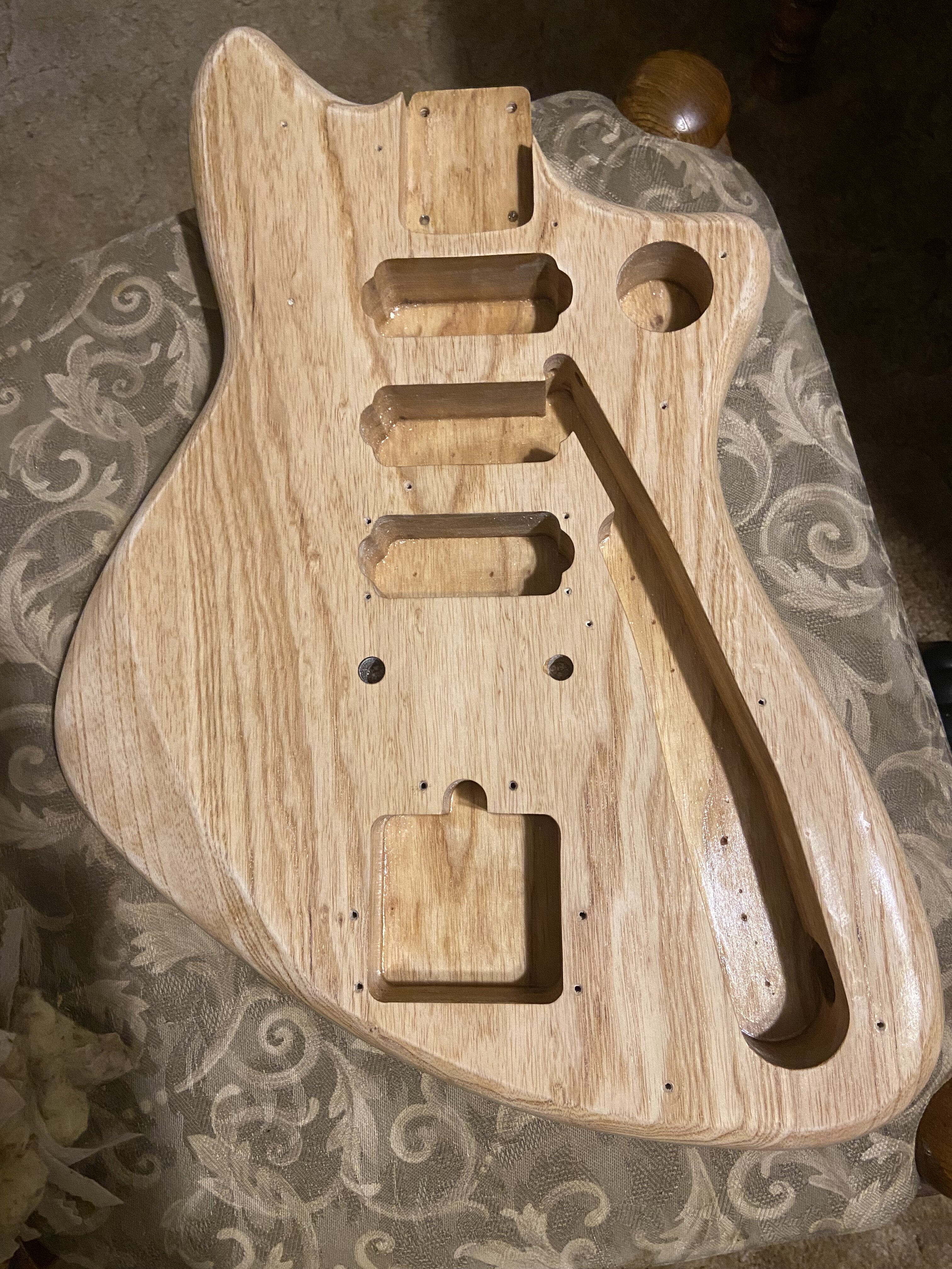

I gotta say the meteora body isn’t just a gimmick. The ergonomics of this are very well thought out.
From the switch to the playing position to your volume and tone knobs, all you need to do is sweep your elbow. Everything falls right in line with your swinging hand.

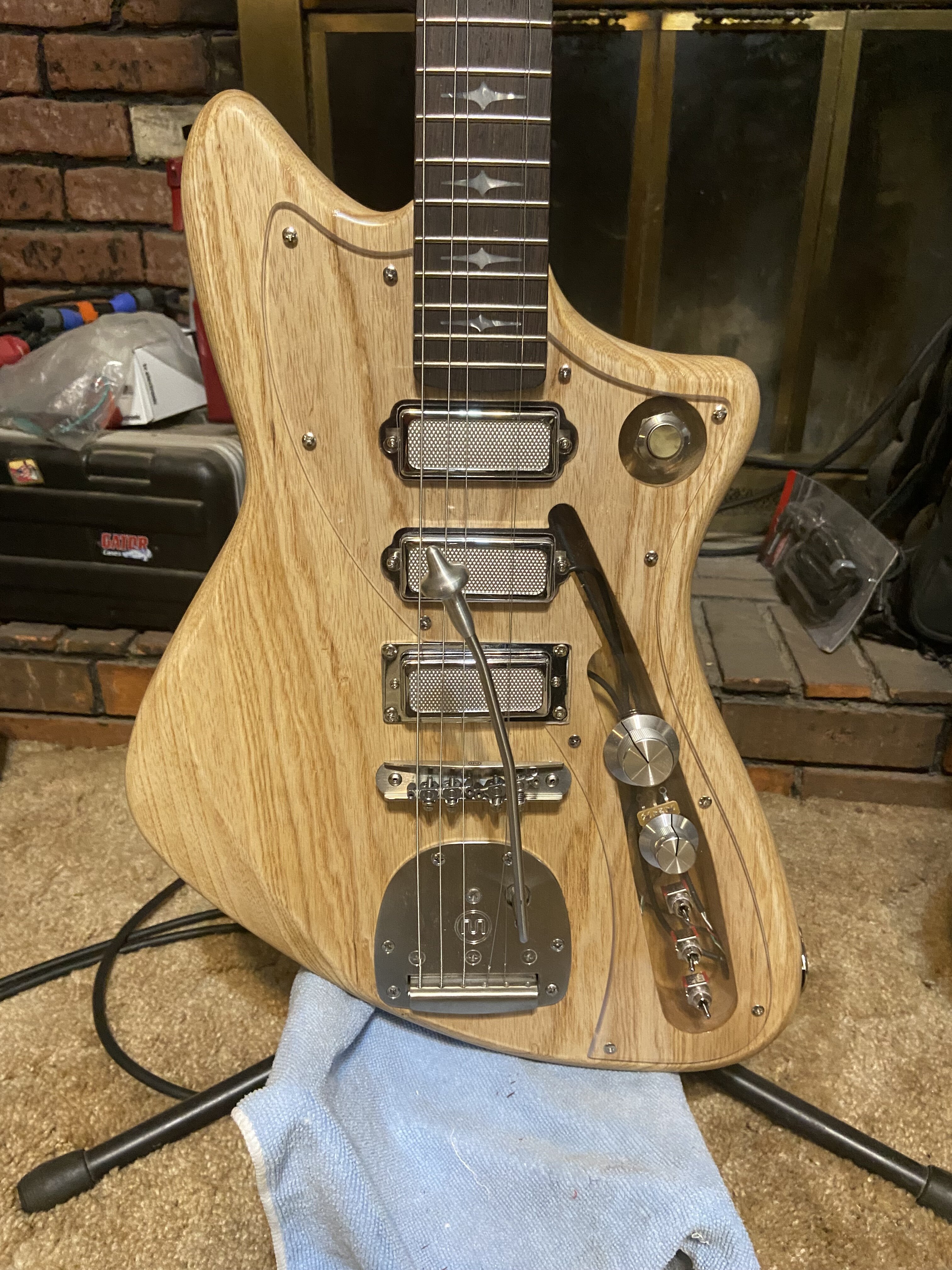

Doing some assembly work on the ash firebird. The clear pickguard is too cool!
It’s not wired up yet. I’m working on the setup. It’s quite loud!
The pickup wiring will be:
Neck/bridge…choose from parallel coils, series coils or off.
Middle…+phase, -phase, off
The round button up front is a momentary kill switch buckethead style.

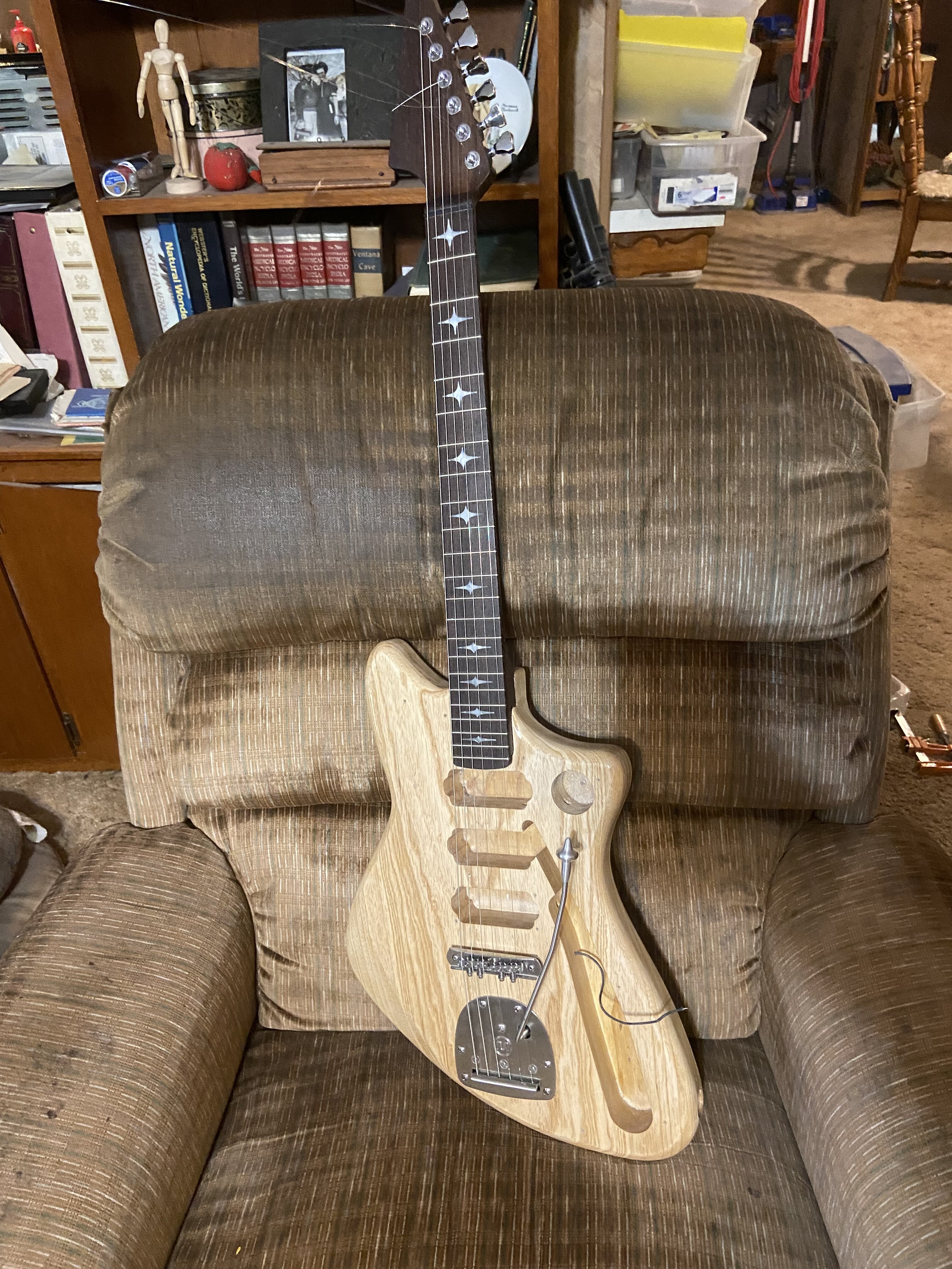

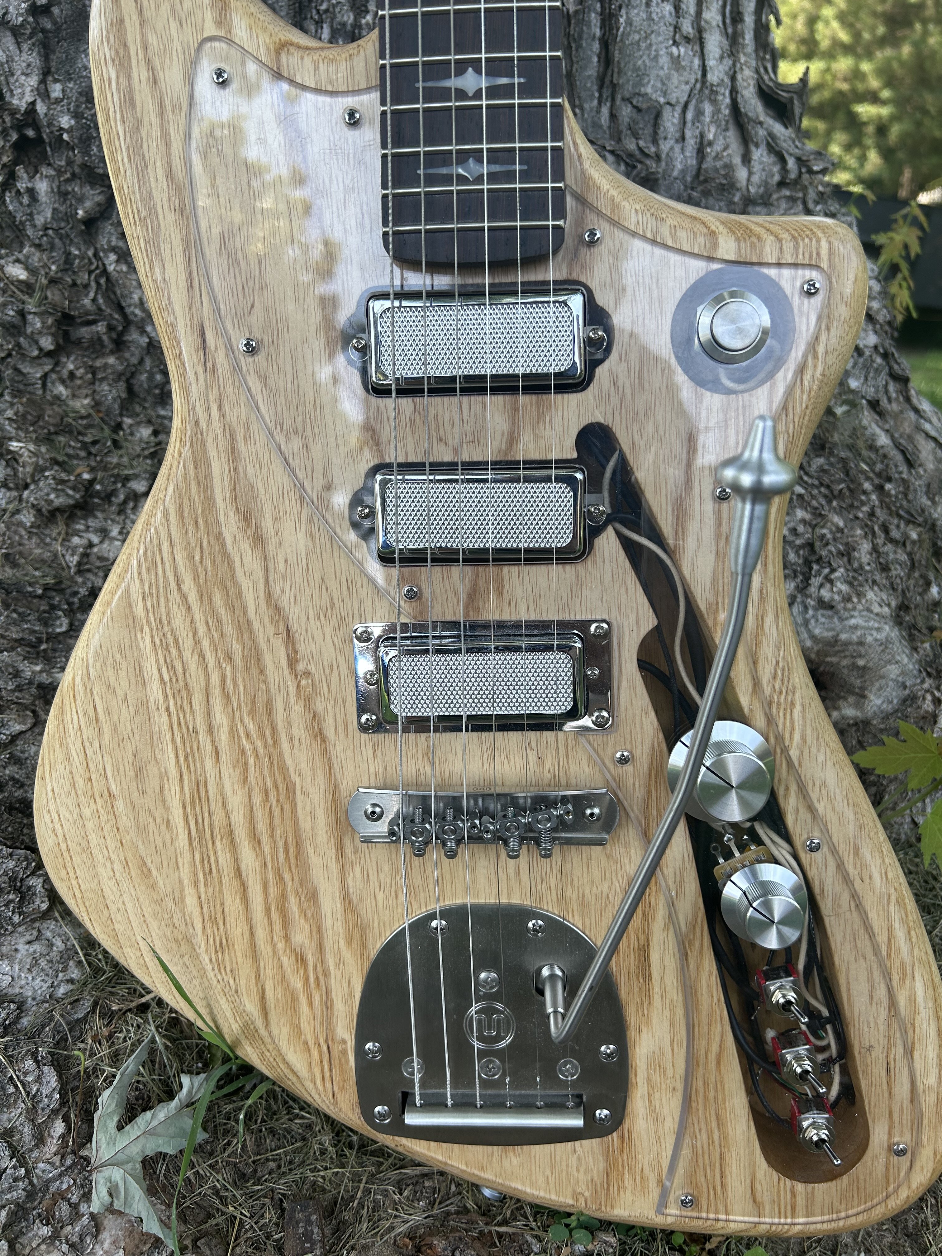

Alright after much rain delay in finish work, one is finished finally!!!
The wiring was hell.
All pups have an on/off/on toggle so you can run any combination of pups you want.
Bridge and neck pups are wired so the switch puts the two coils in parallel or series or off.
Neck pickup switch allows you to switch electrical phase or turn it off.
The big round button on the lower horn is a momentary kill switch.
