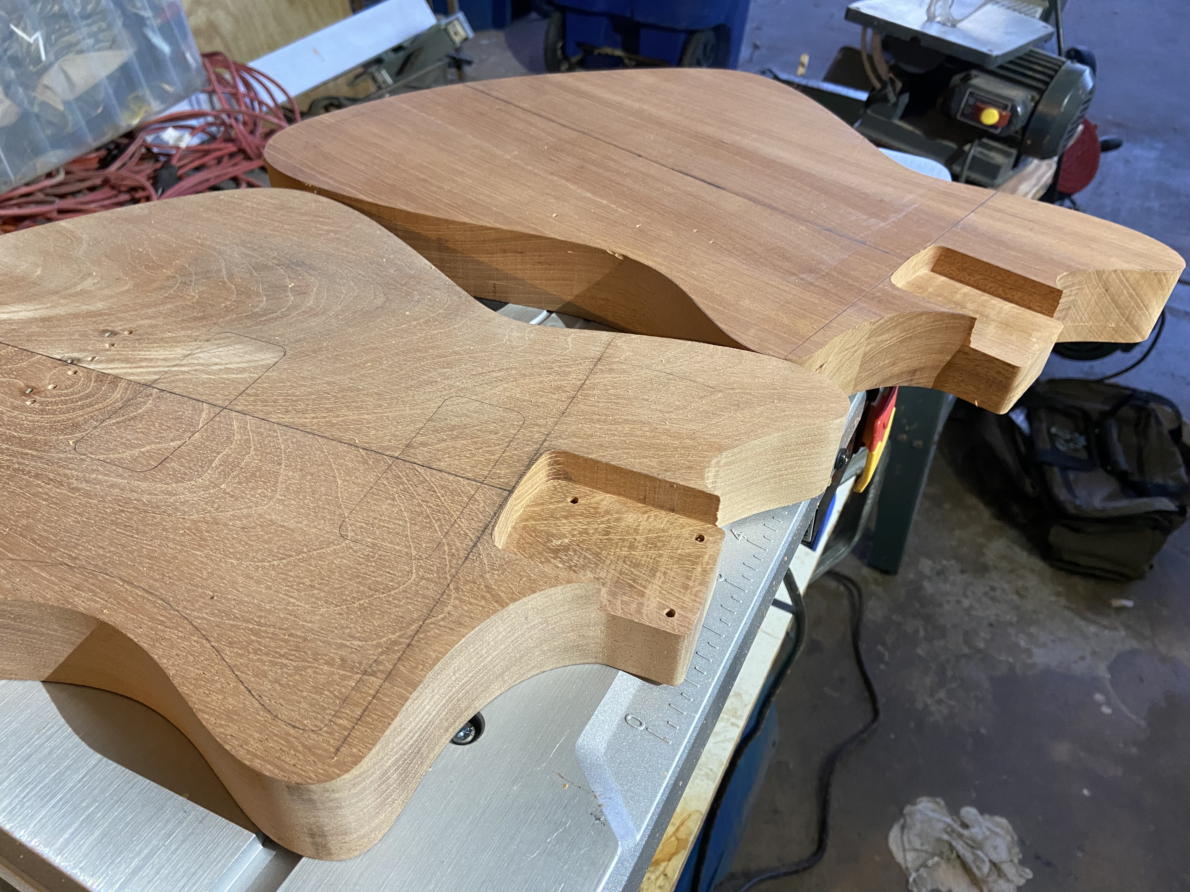

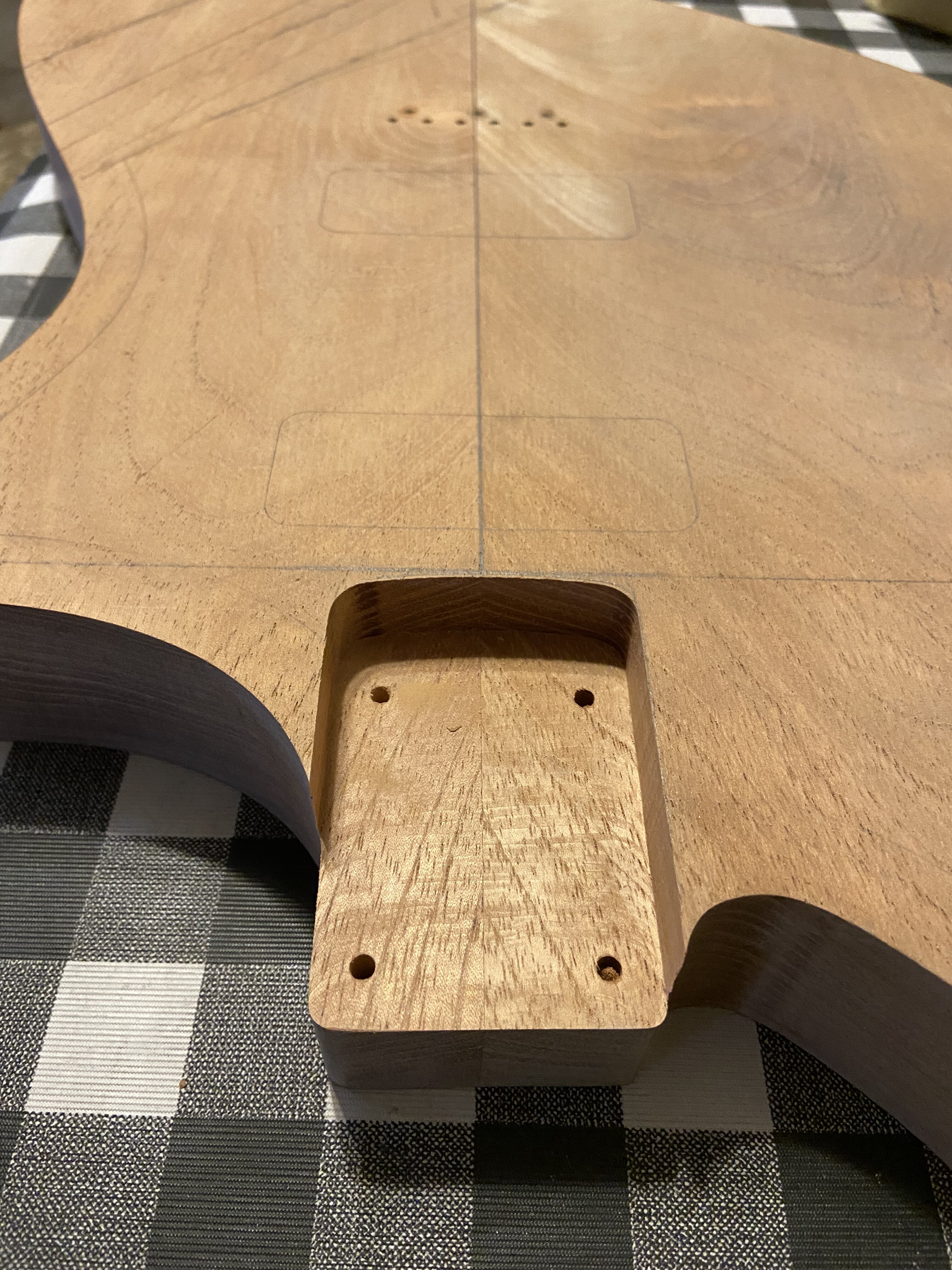

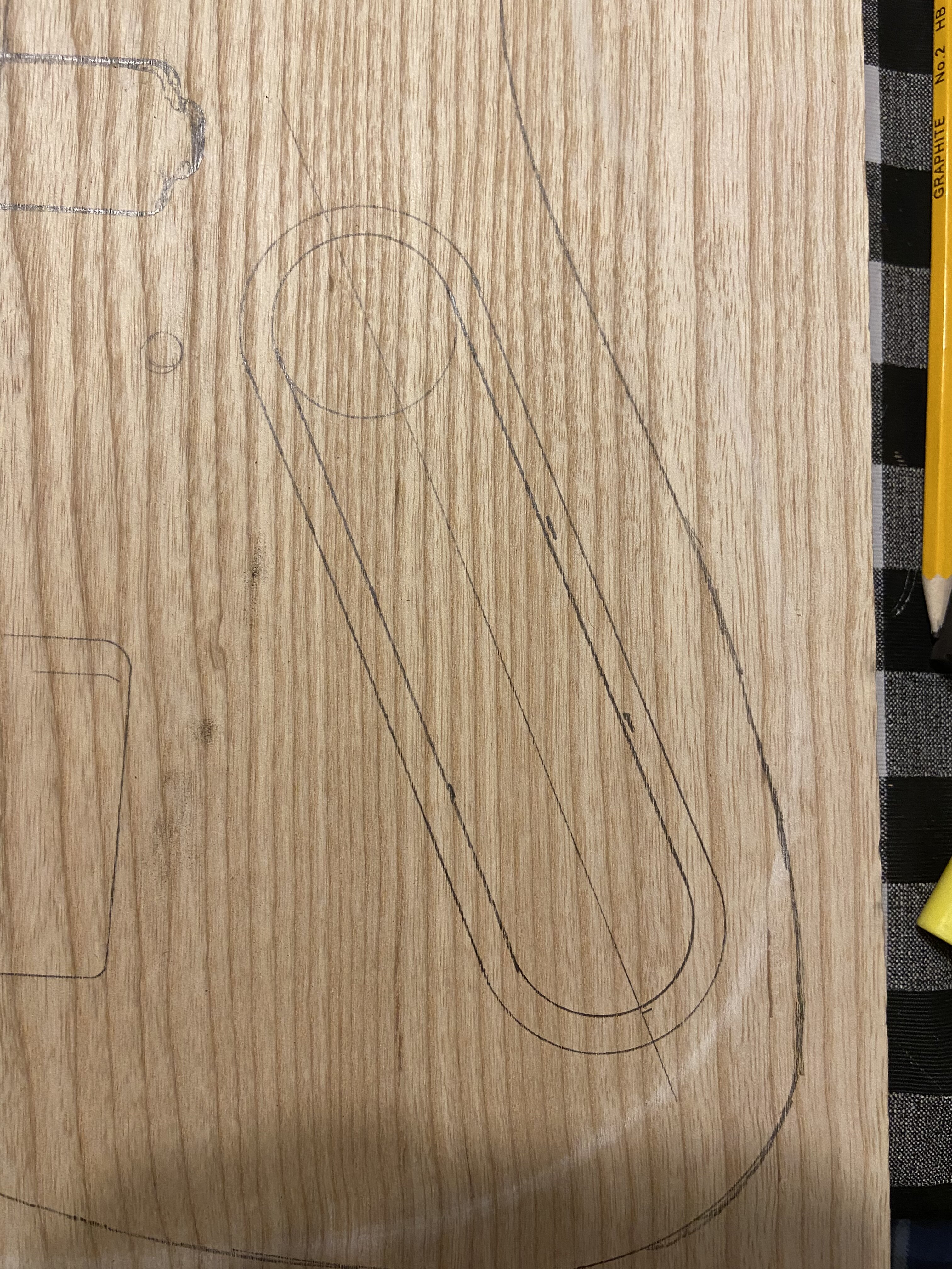

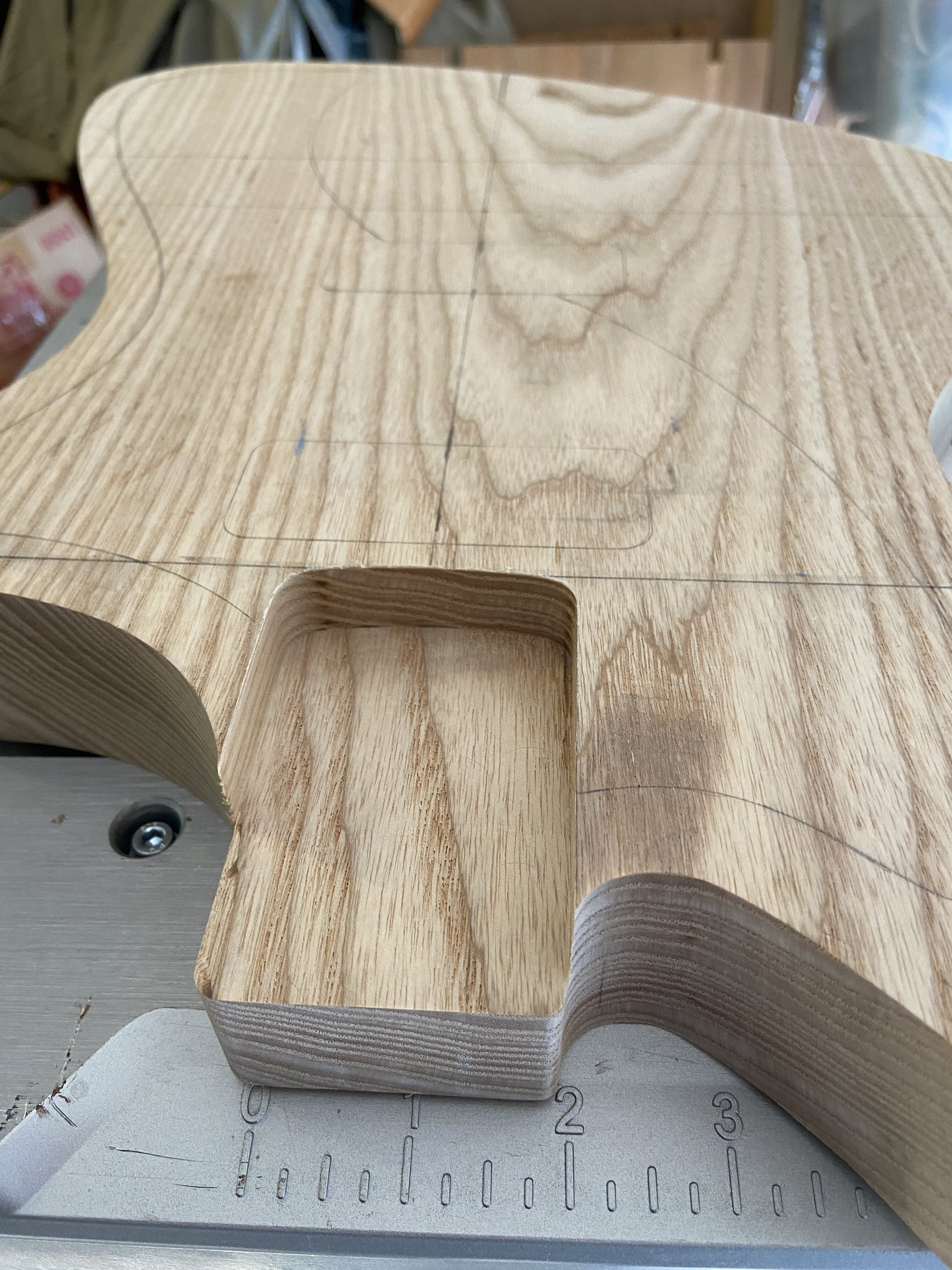

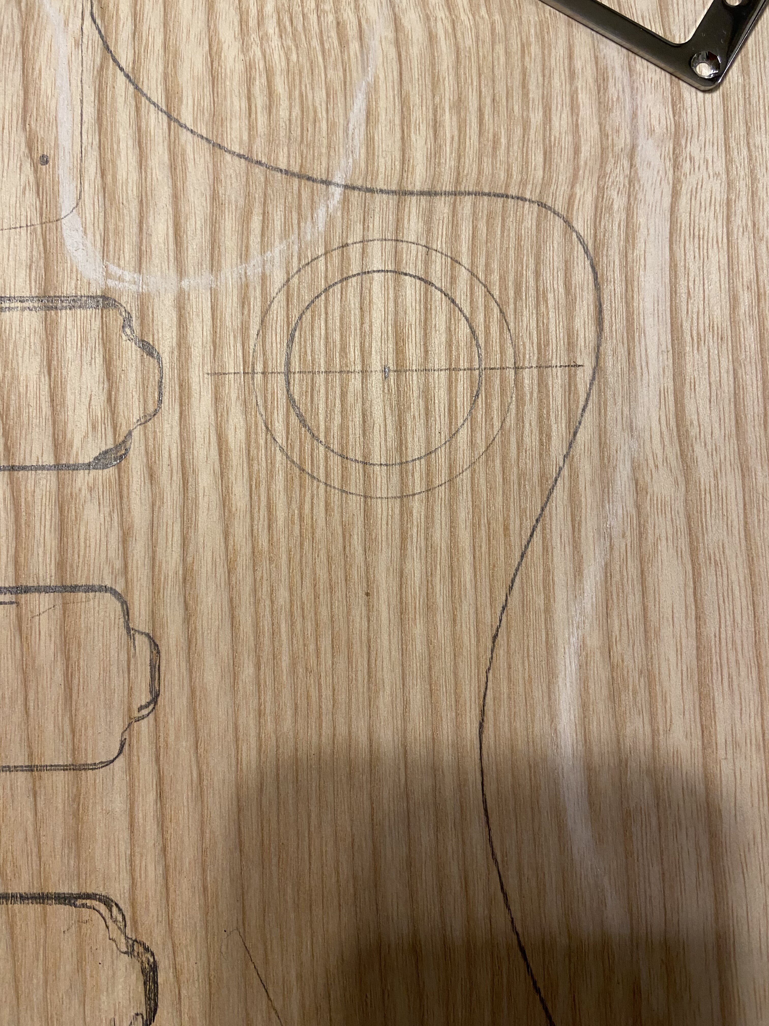

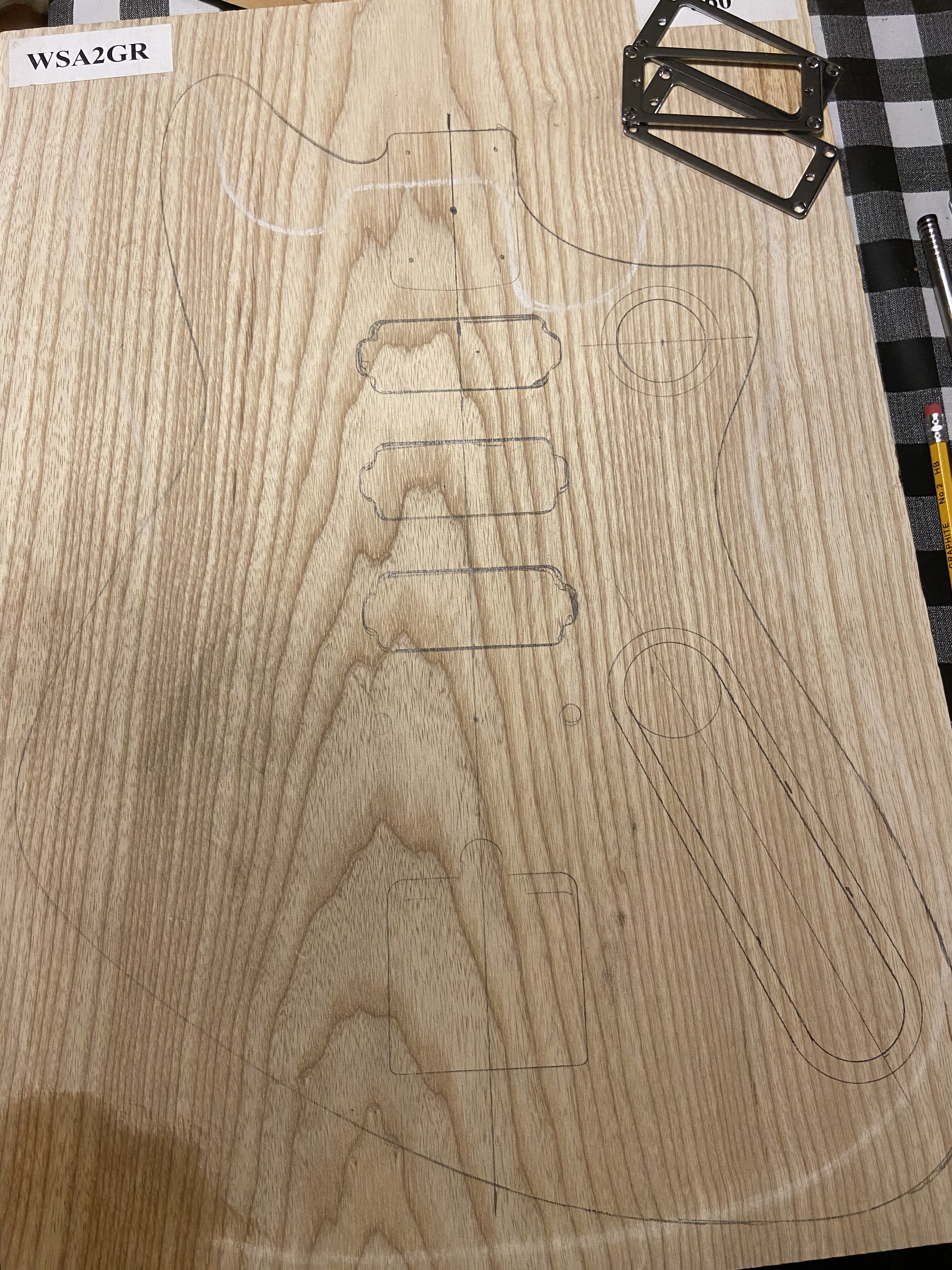

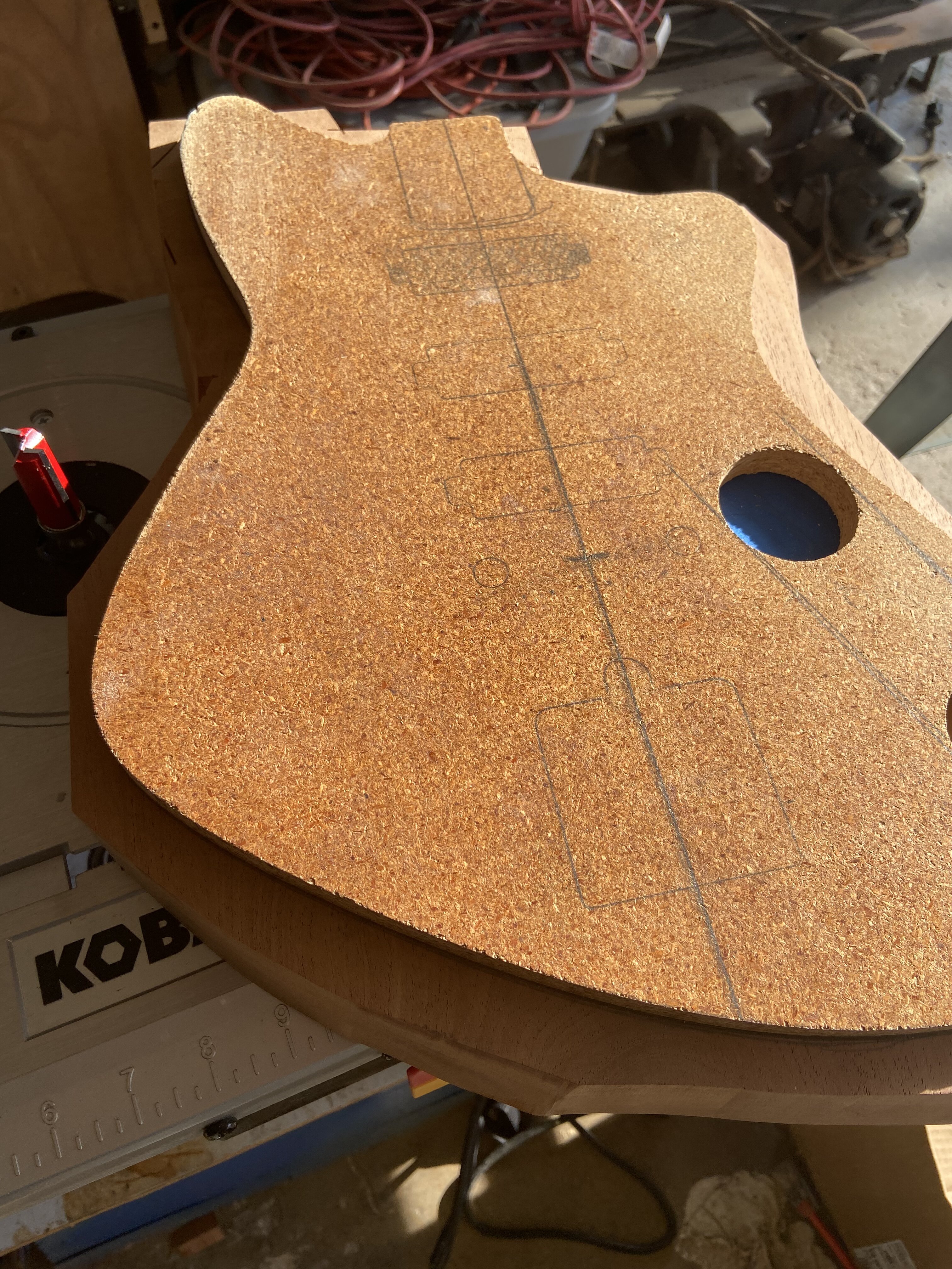

Going to make some meteoras!
Both control plates will be front routed and covered with a clear plexiglass cover.

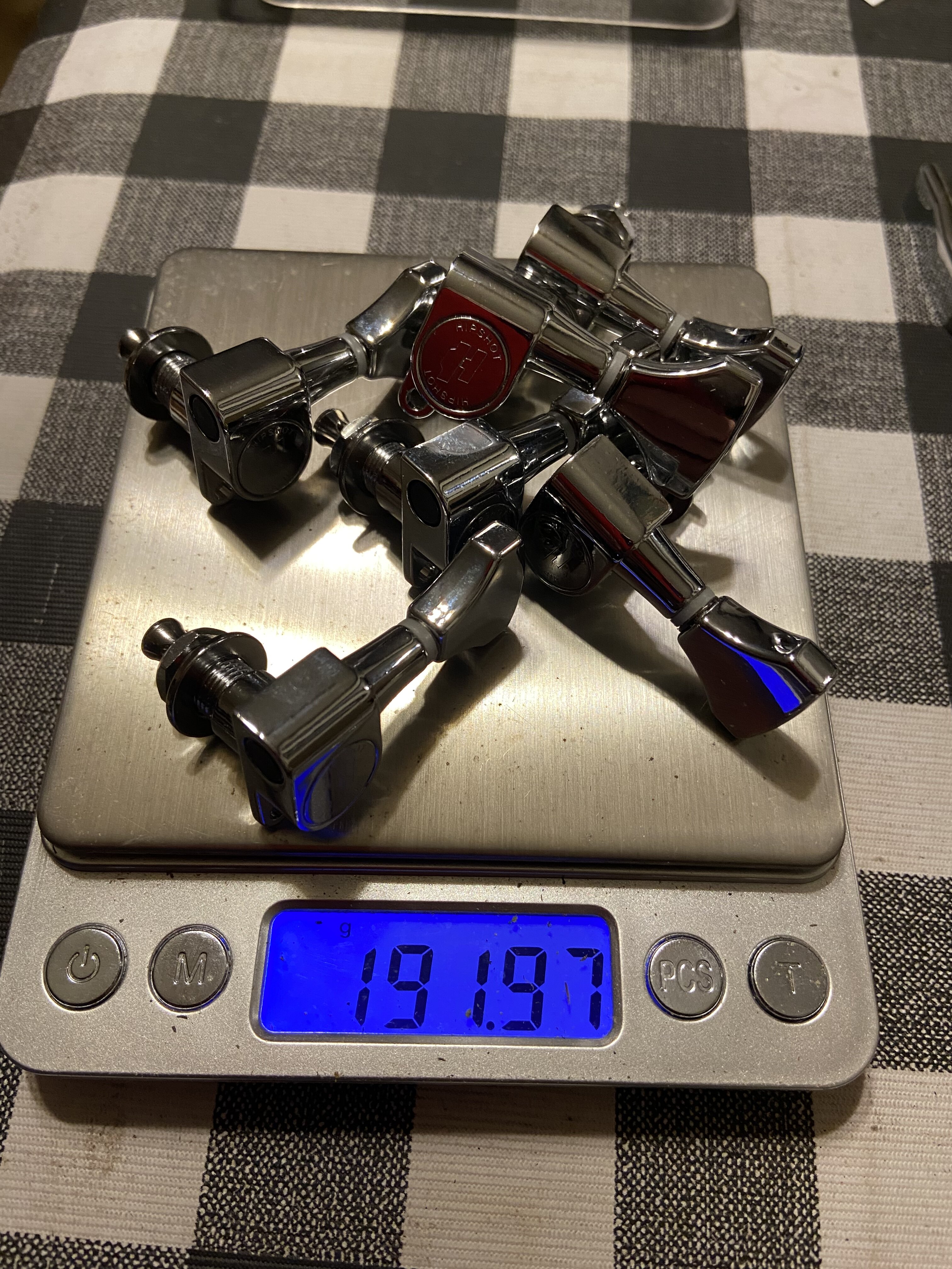

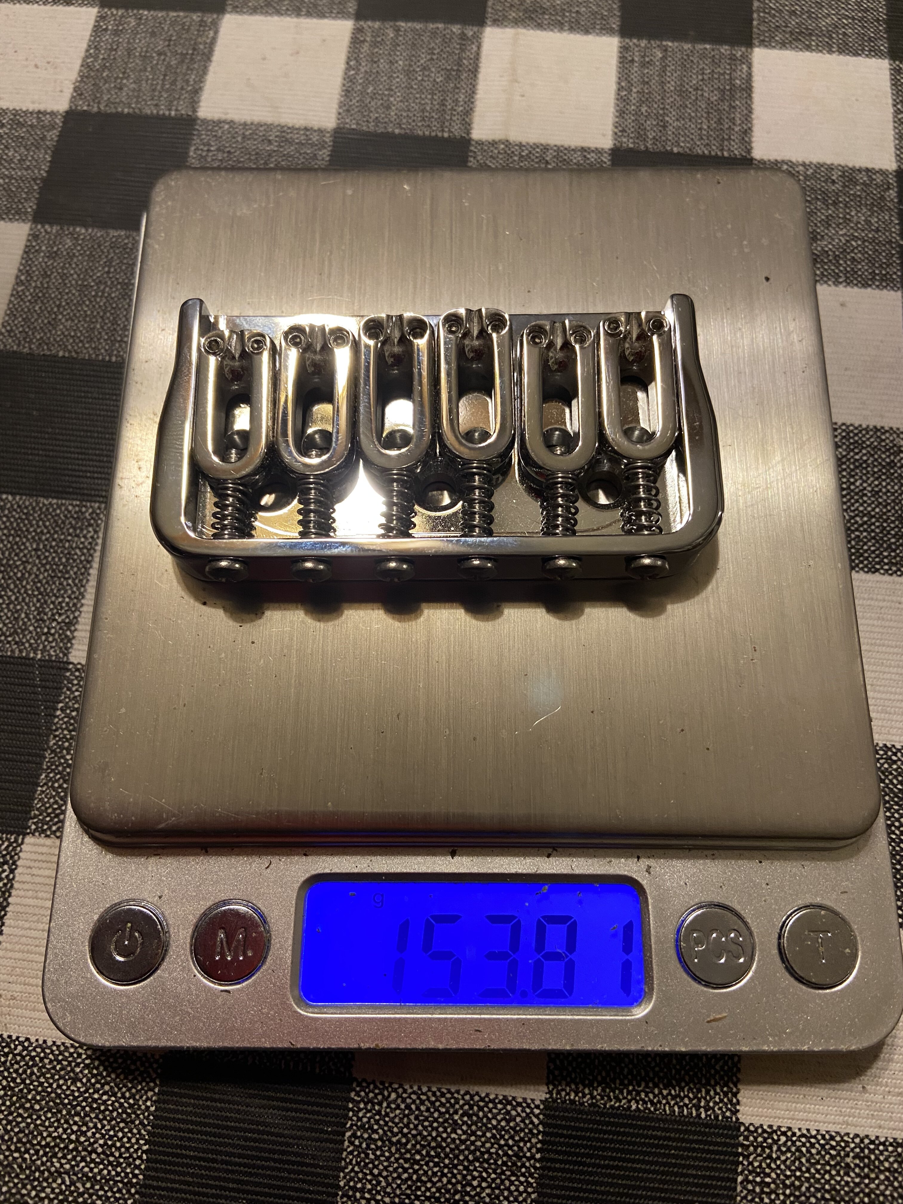

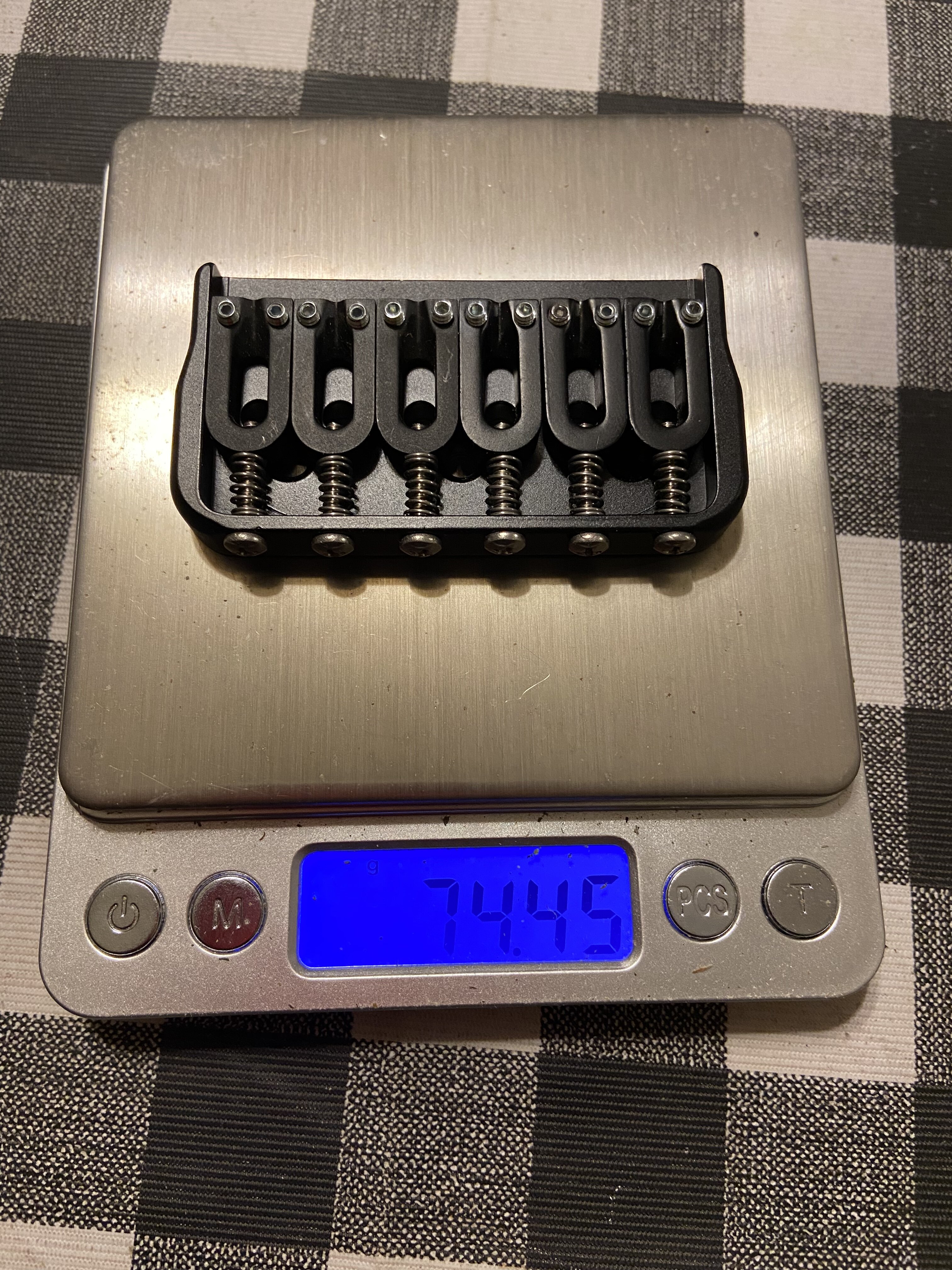

Check this out. I have two identical bridges. Hipshot hardtail strat. One is chrome and has a brass .175 base with stainless saddles. The other is black with an aluminum.175 base and stainless saddles. The weight difference is astonishing. Weight displayed in grams. 75 vs 154

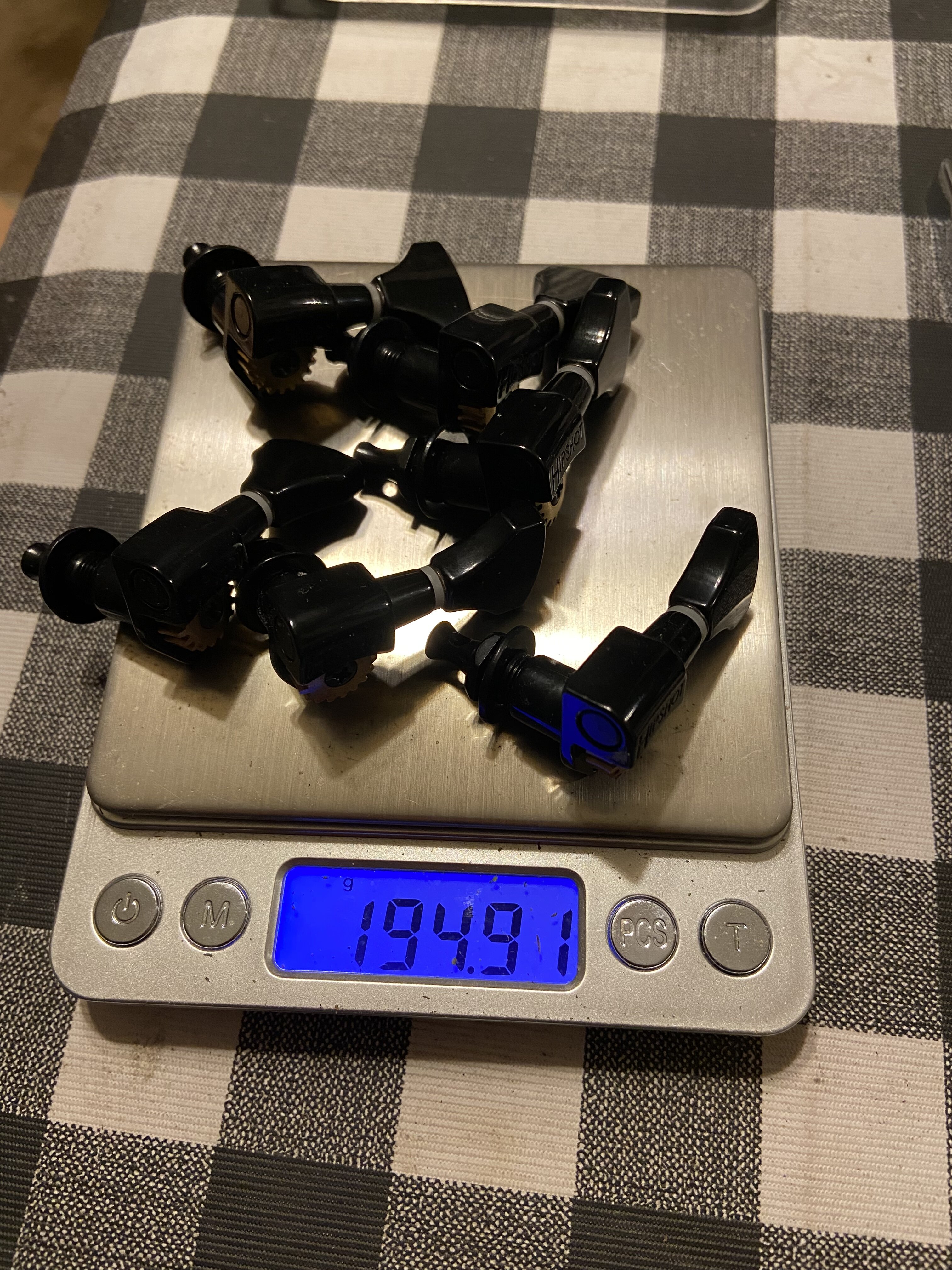

Also of note. Hipshot open gear “ultralight” tuners are 2 grams heavier than Hipshot closed case Schaller clone tuners.

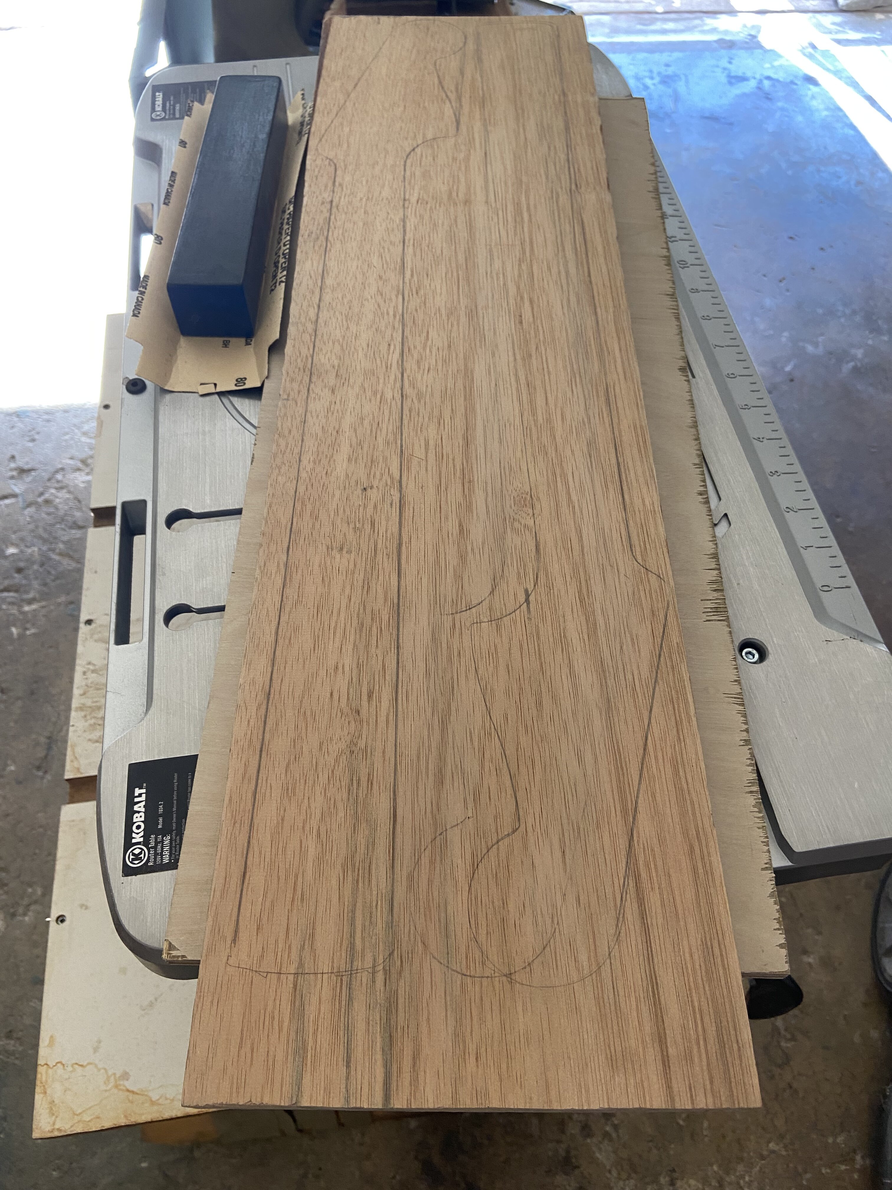

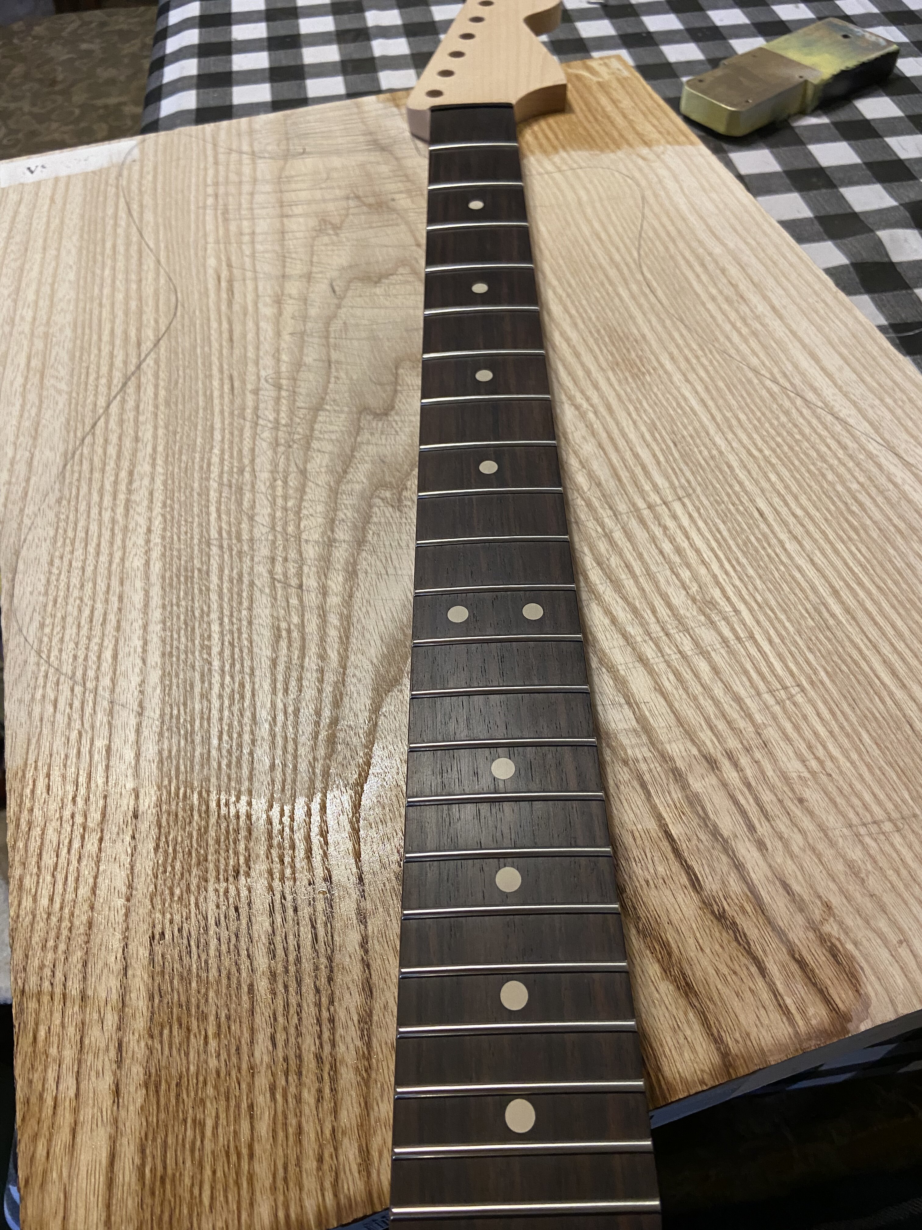

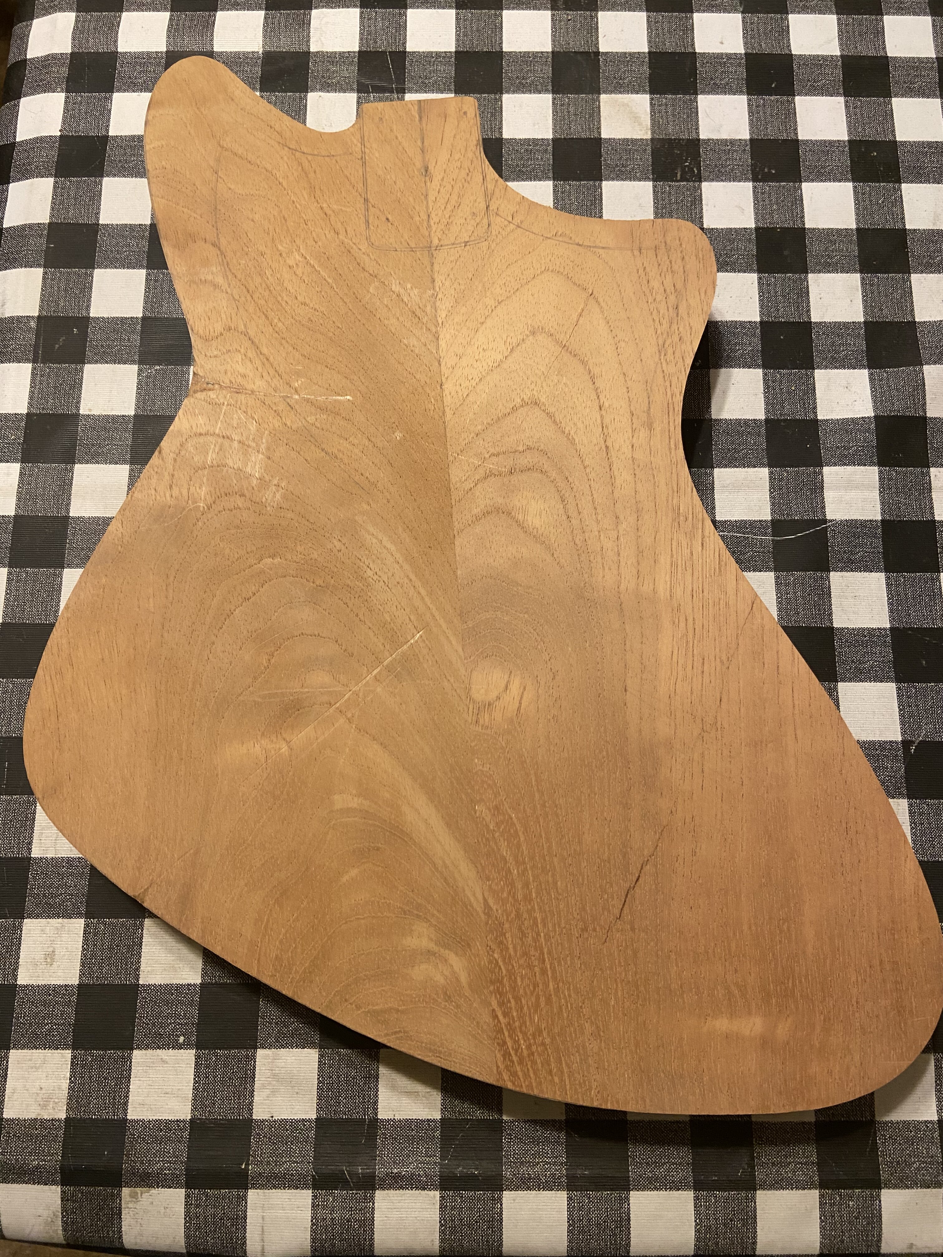

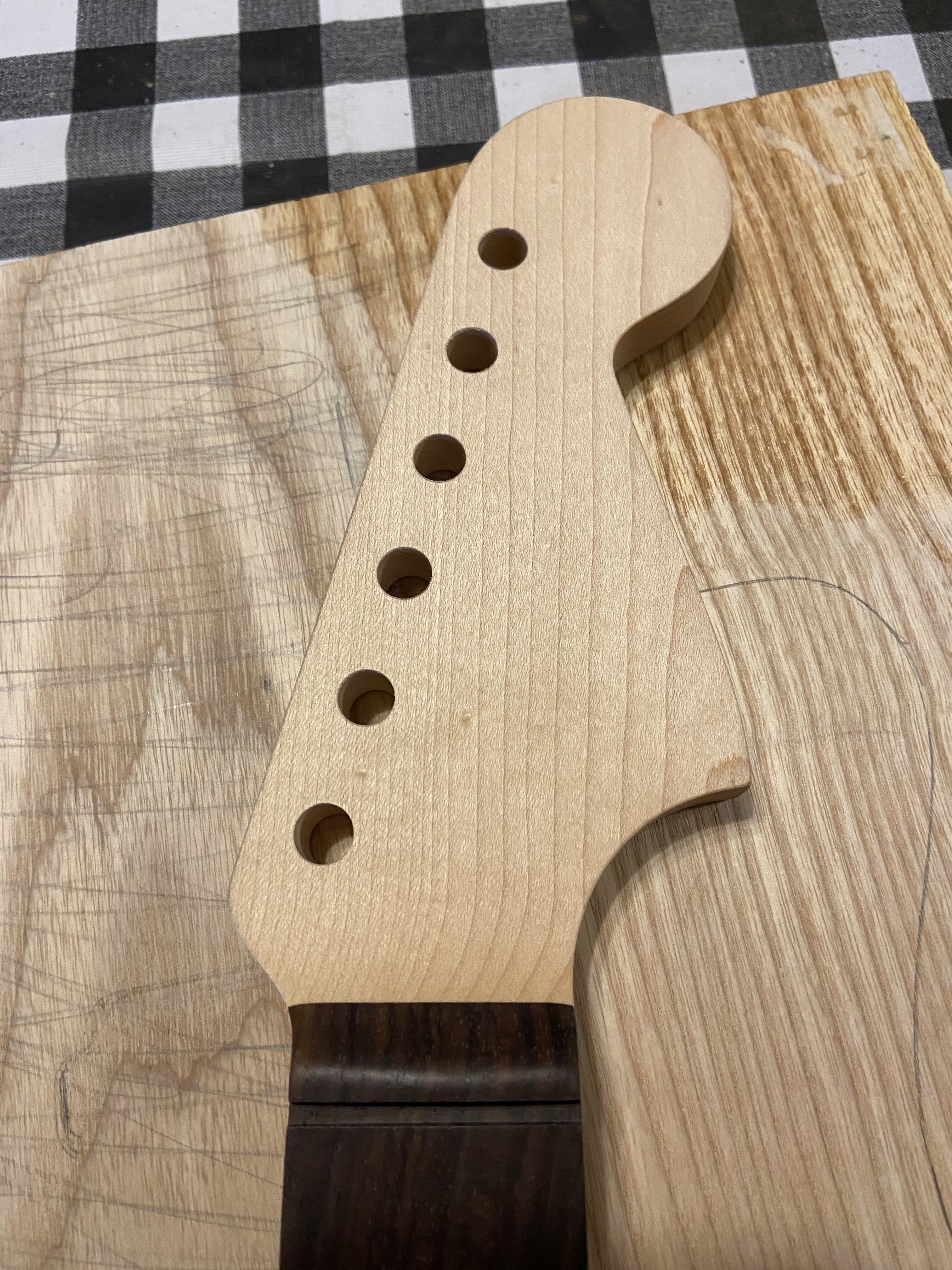

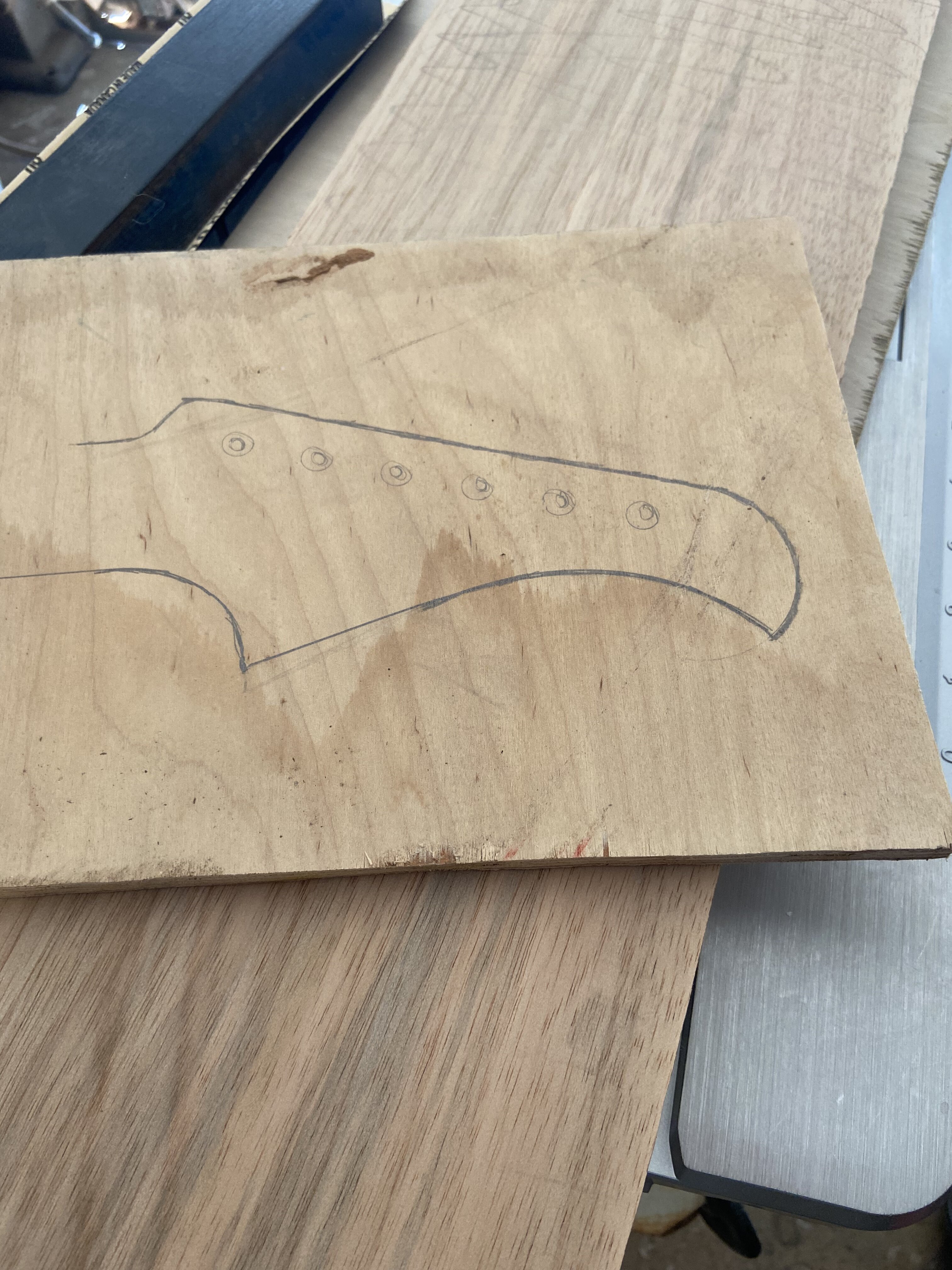

Today’s business. Getting this chunk of African mahogany prepped to become two necks. One is going on my P90 build. The Warmoth neck went on to Foo. The bass I was gonna make for him has morphed into a double humbucker hardtail.

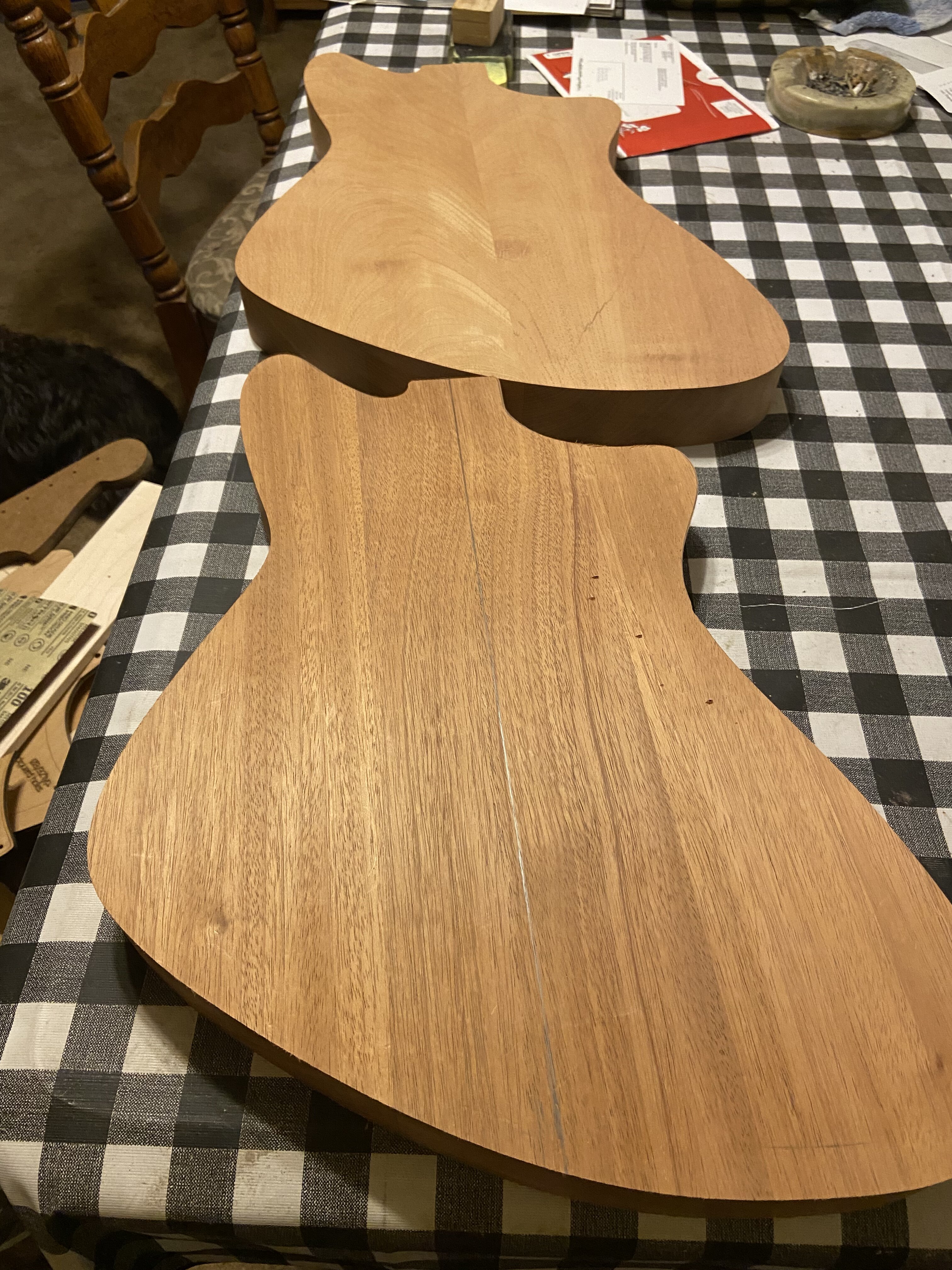

Don't like it, sorry. Too much eighties Hondo, Memphis starter Strat vibes.
Draw a bunch up on paper to size and see which one grows on you over night.
