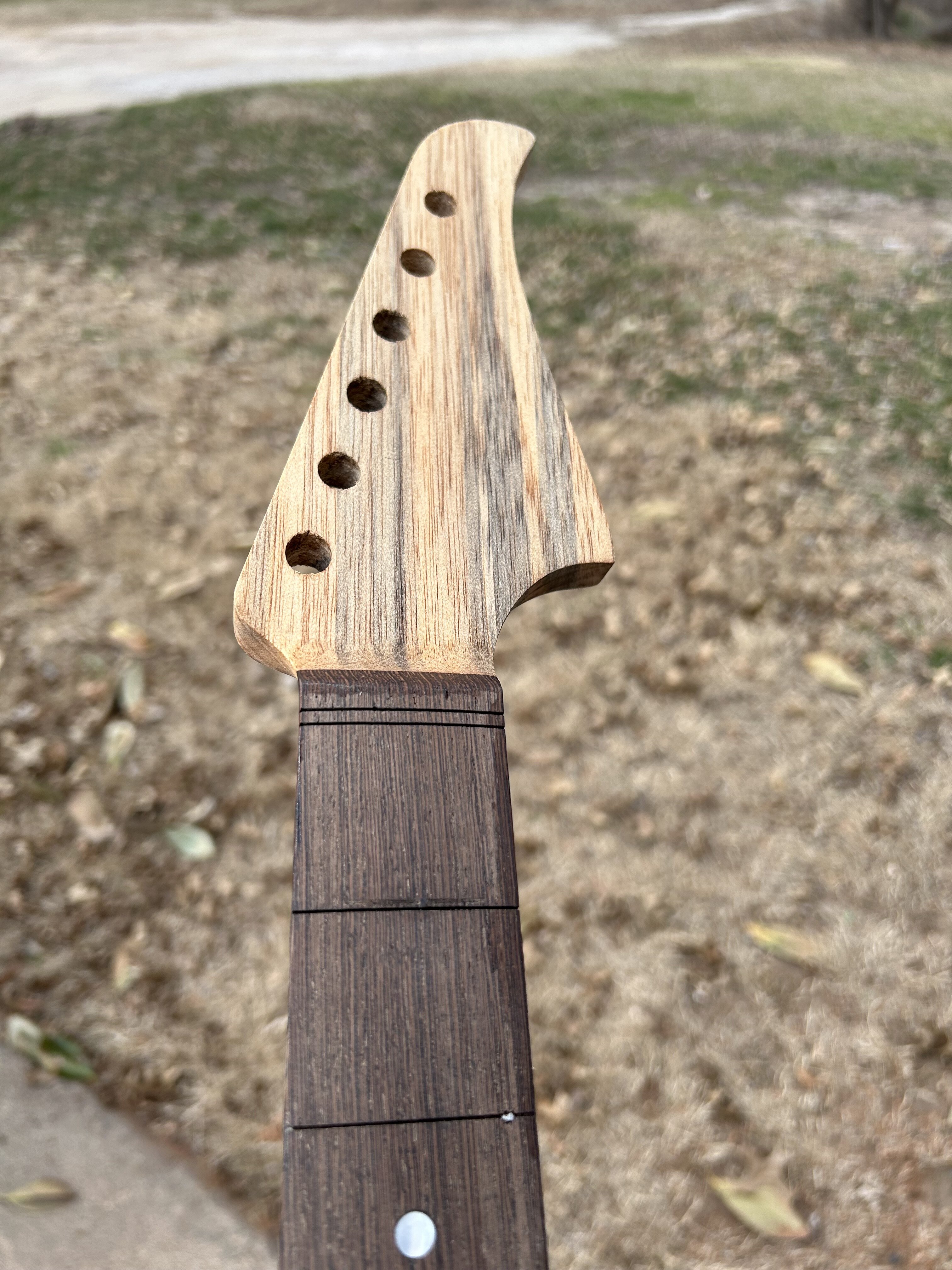

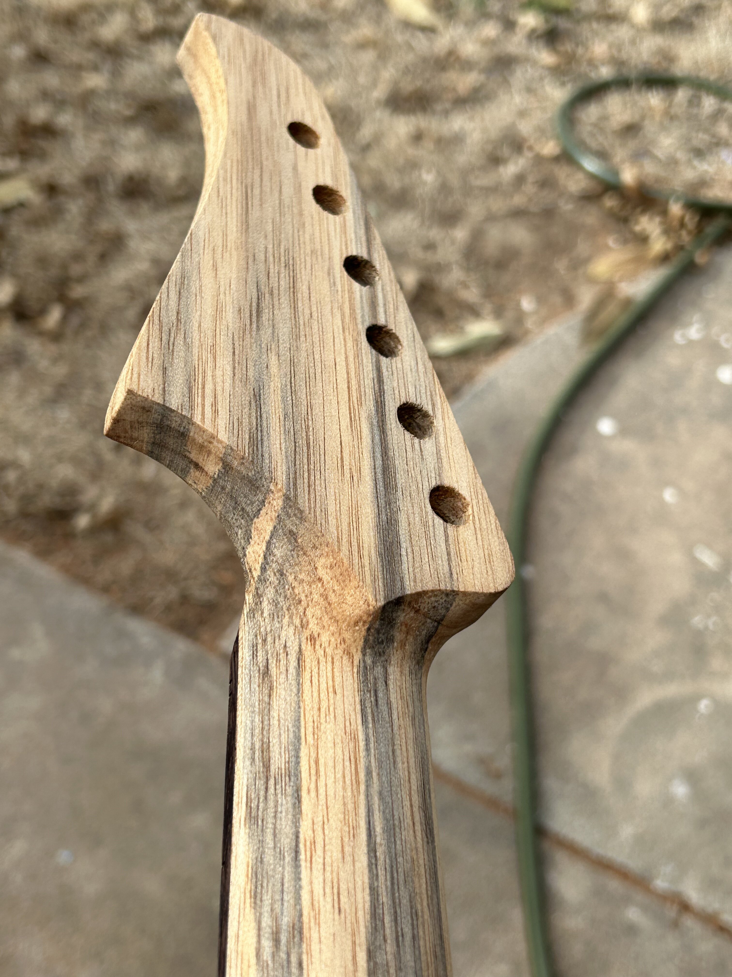

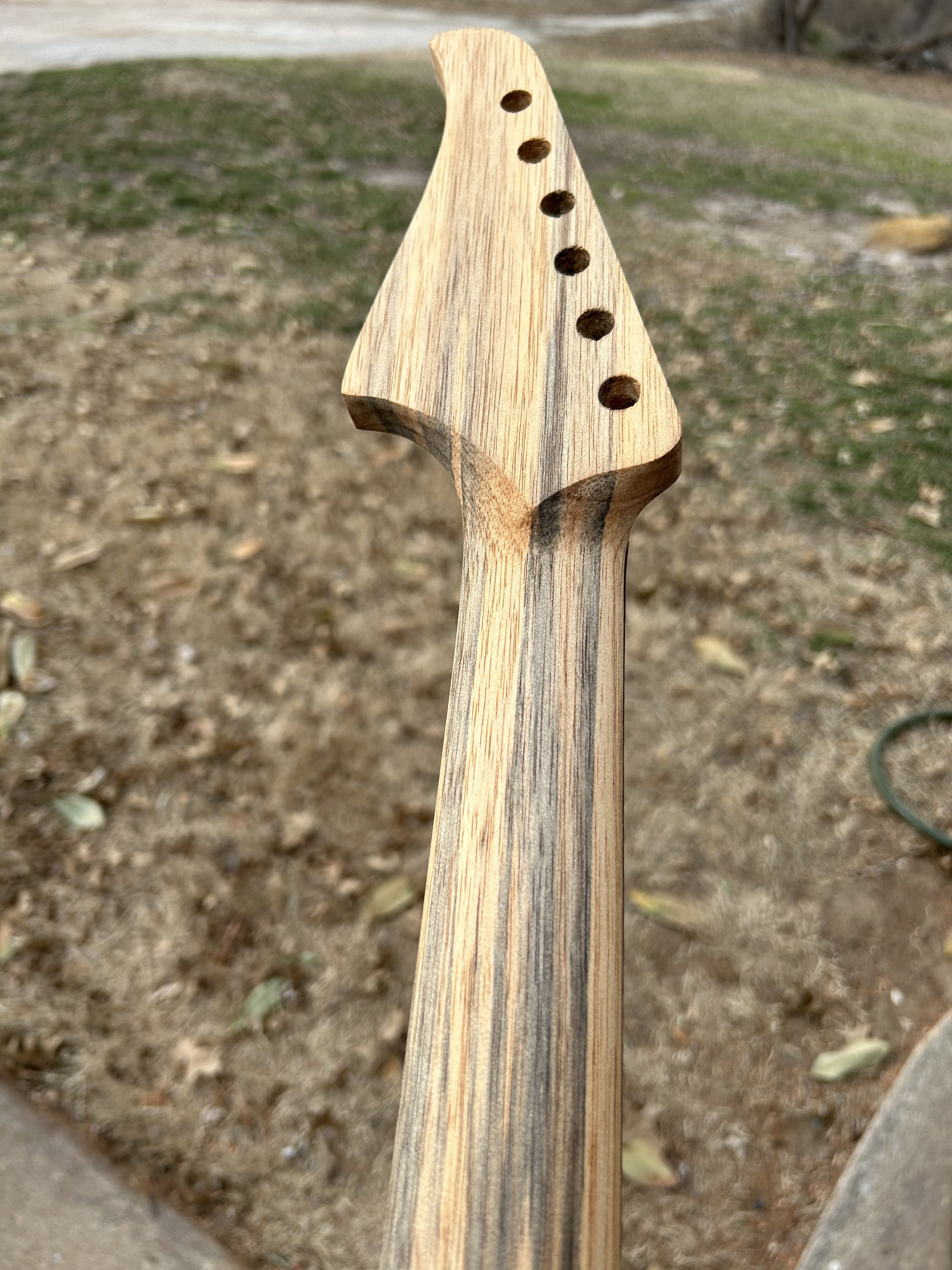

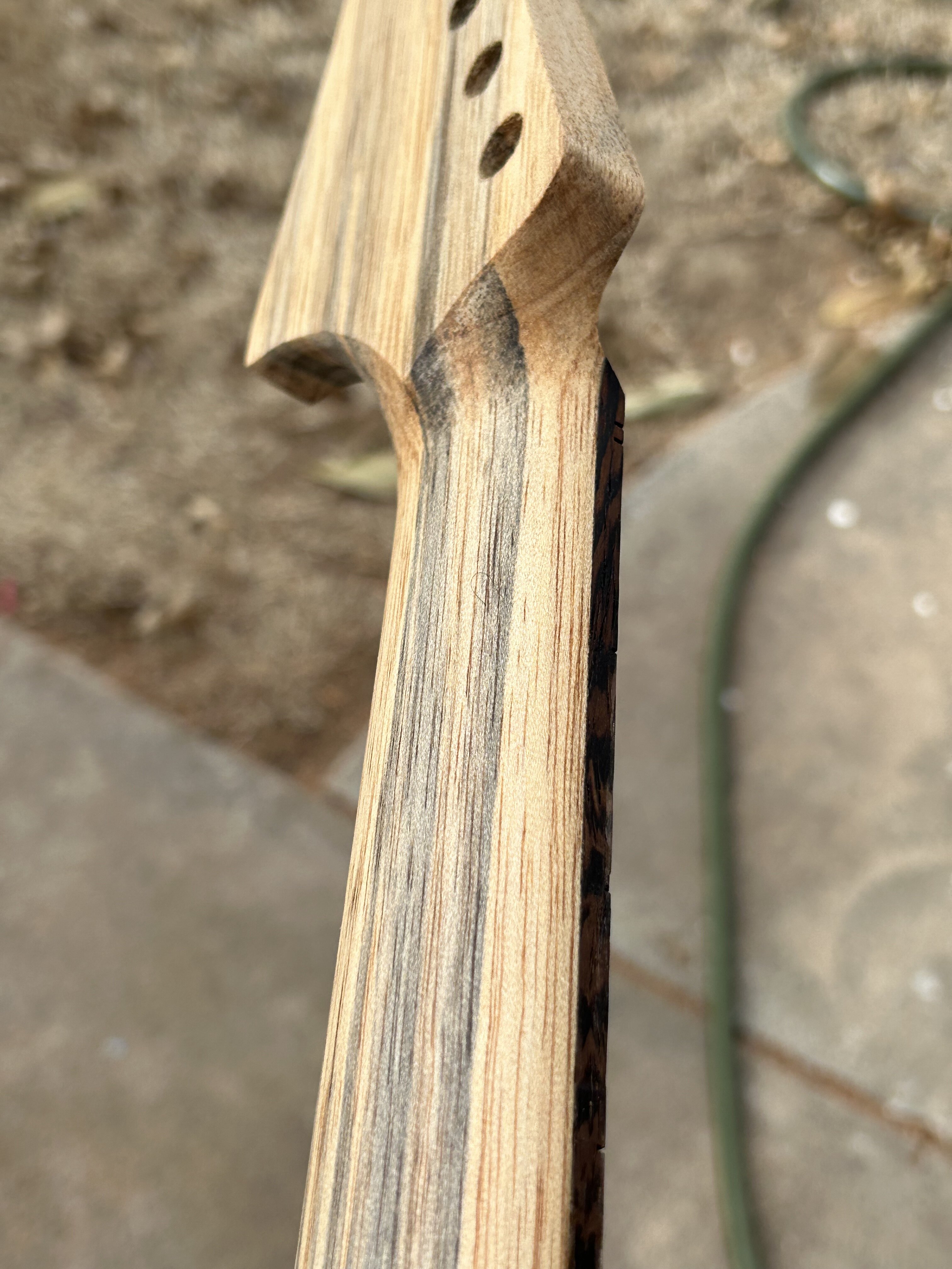

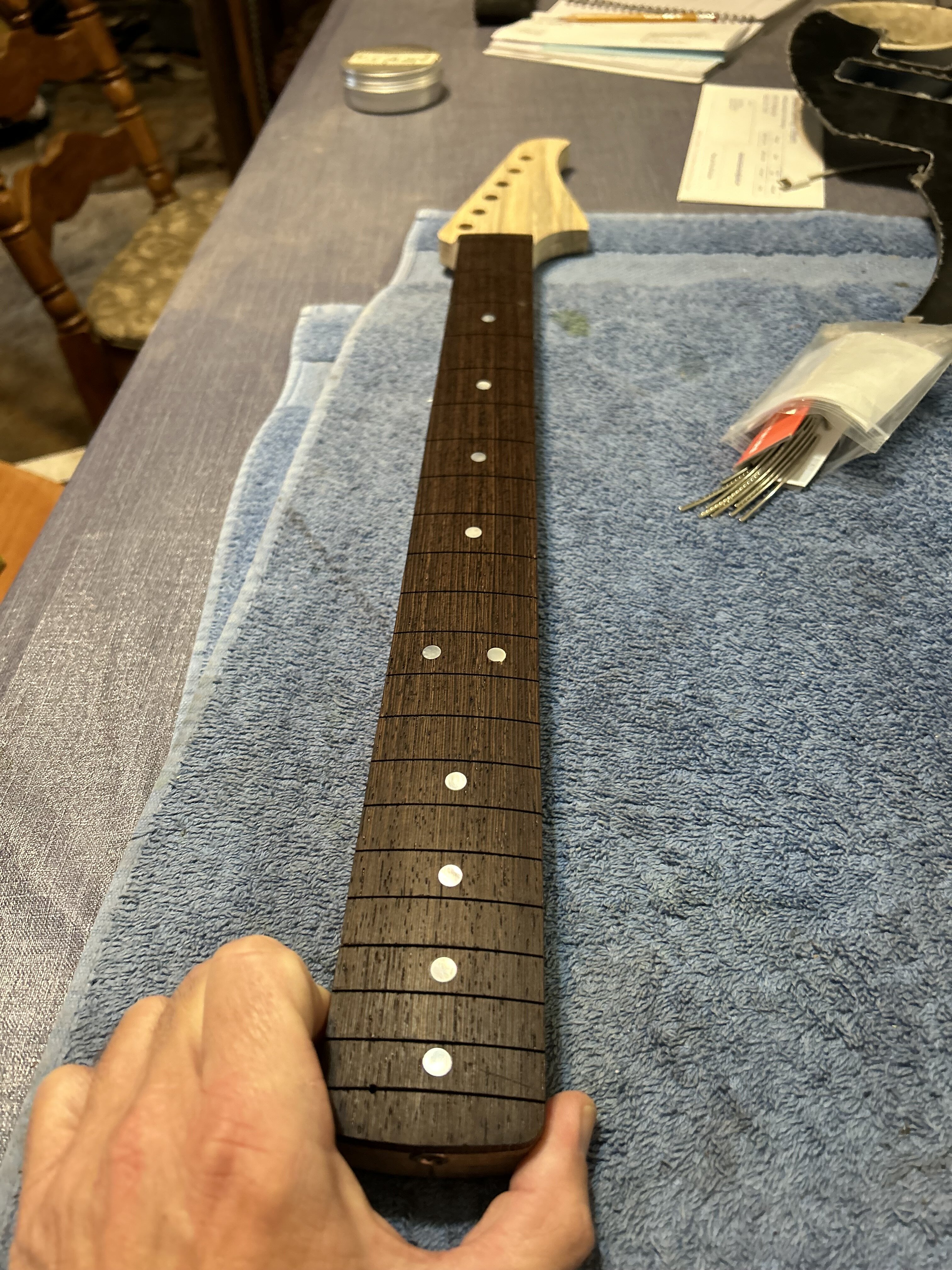

I have a neck now! This is black limba topped with wenge. Super light. 7.25 radius. 0.84” thick at the first fret. 0.95” at the 12th.

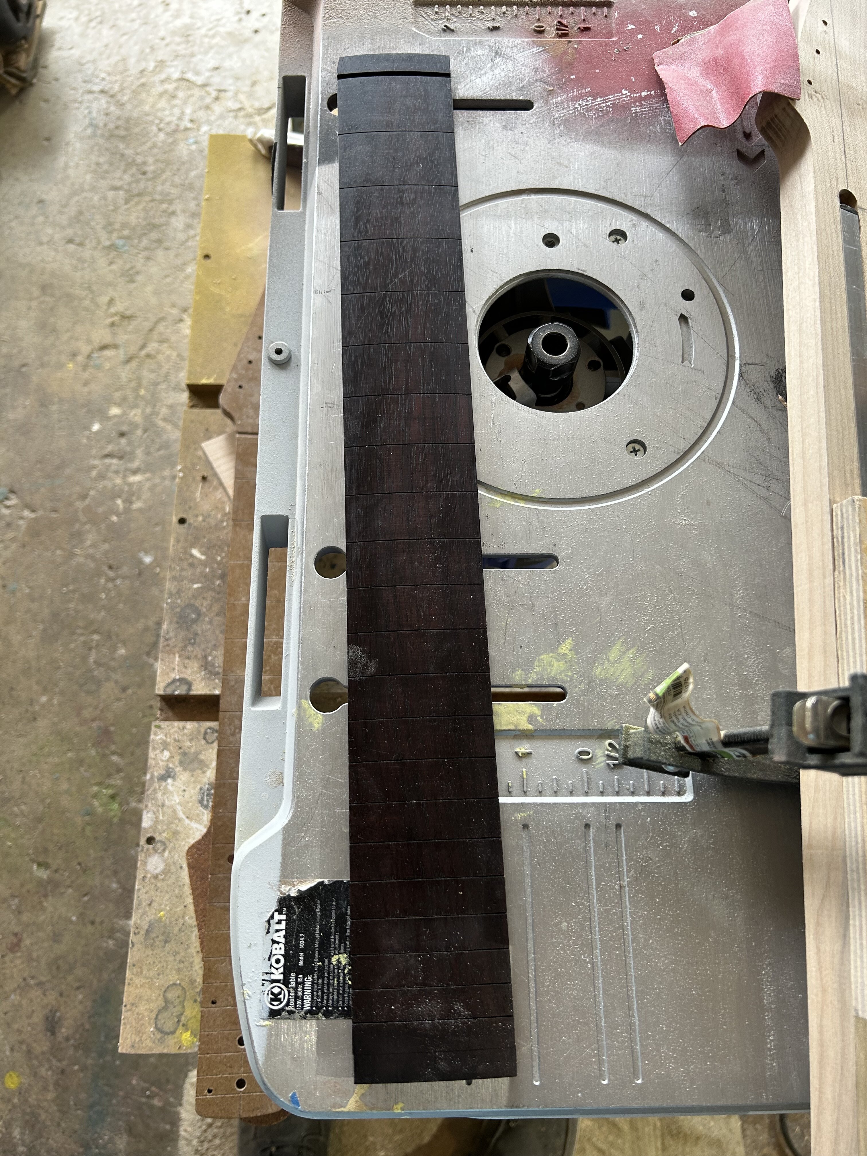

This limba carves way easier than maple! The wenge splinters like anything. It’s a cool fretboard but I won’t be using it again lol.
This limba carves way easier than maple! The wenge splinters like anything. It’s a cool fretboard but I won’t be using it again lol. View attachment 90412View attachment 90413View attachment 90416View attachment 90414View attachment 90415
That Black Limba neck is killer! I have some laying around that I am trying to decide what to do with. (I won't be doing a guitar neck)
Wenge is beautiful but definitely a pain in the ass. That open grain really does want to splinter. Black Palm is even worse.
I am currently building with Peruvian Walnut that is just gorgeous and a real pleasure to work. I was cutting miters and it was just smooth as glass. Not sure how it would do as a tone wood but it is definitely pretty! lol
Yeah the wenge loves to splinter and so does the black palm. Ugh I tried to work with that stuff once and gave up!

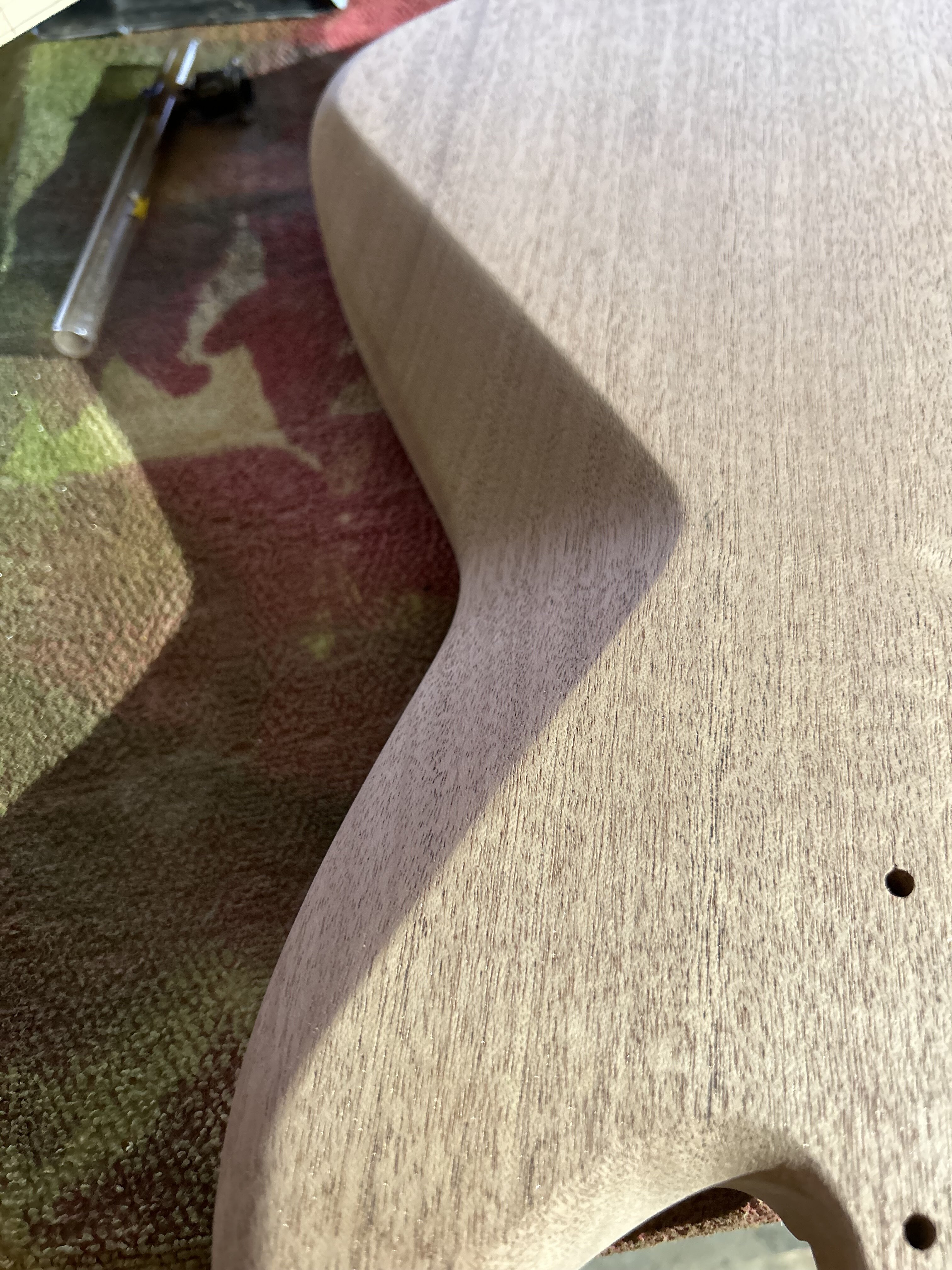

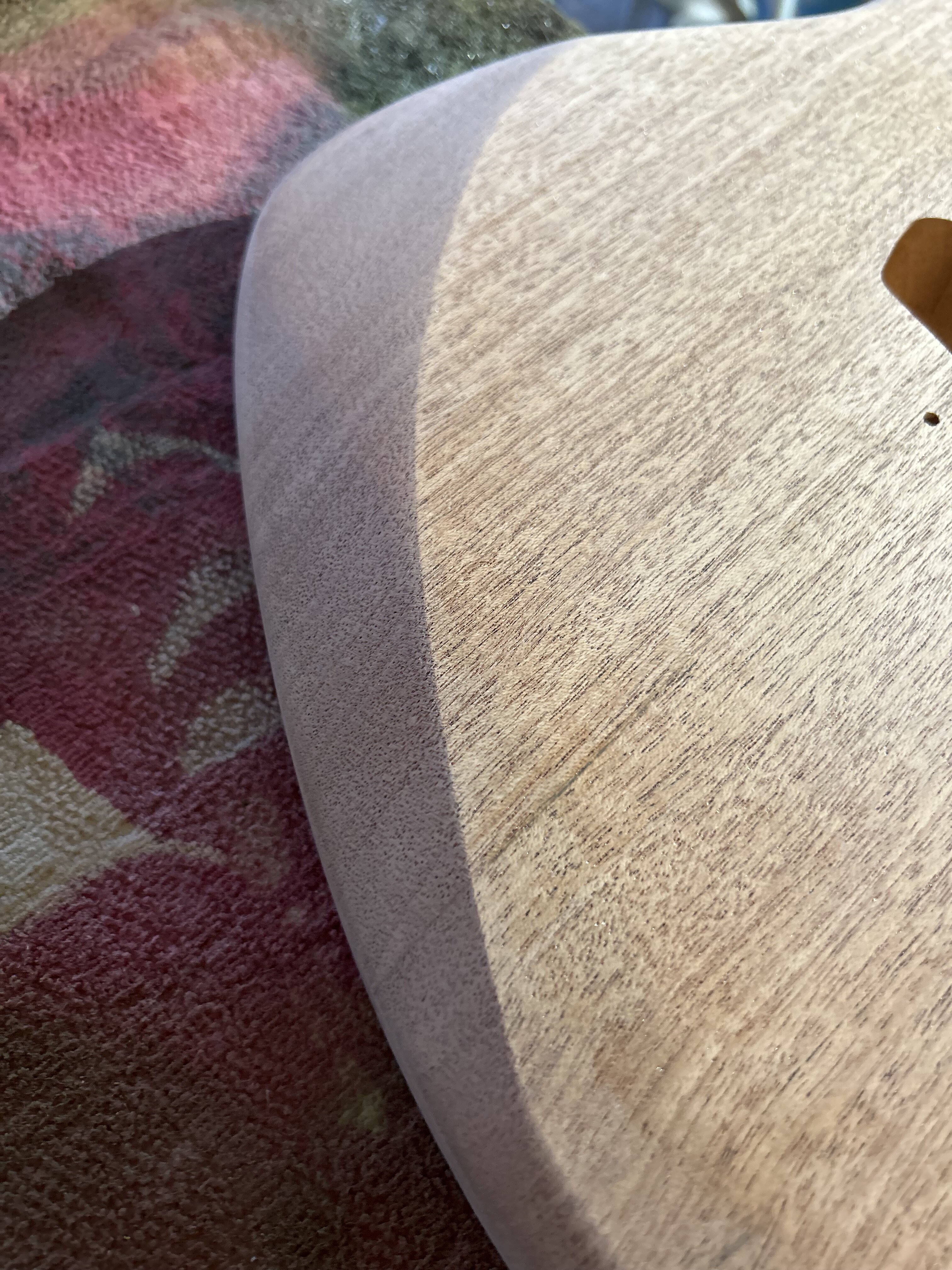

And this is how we do comfort carves. A die grinder with nasty teeth spinning at 25,000 RPM! It will rip this out in about a minute flat.

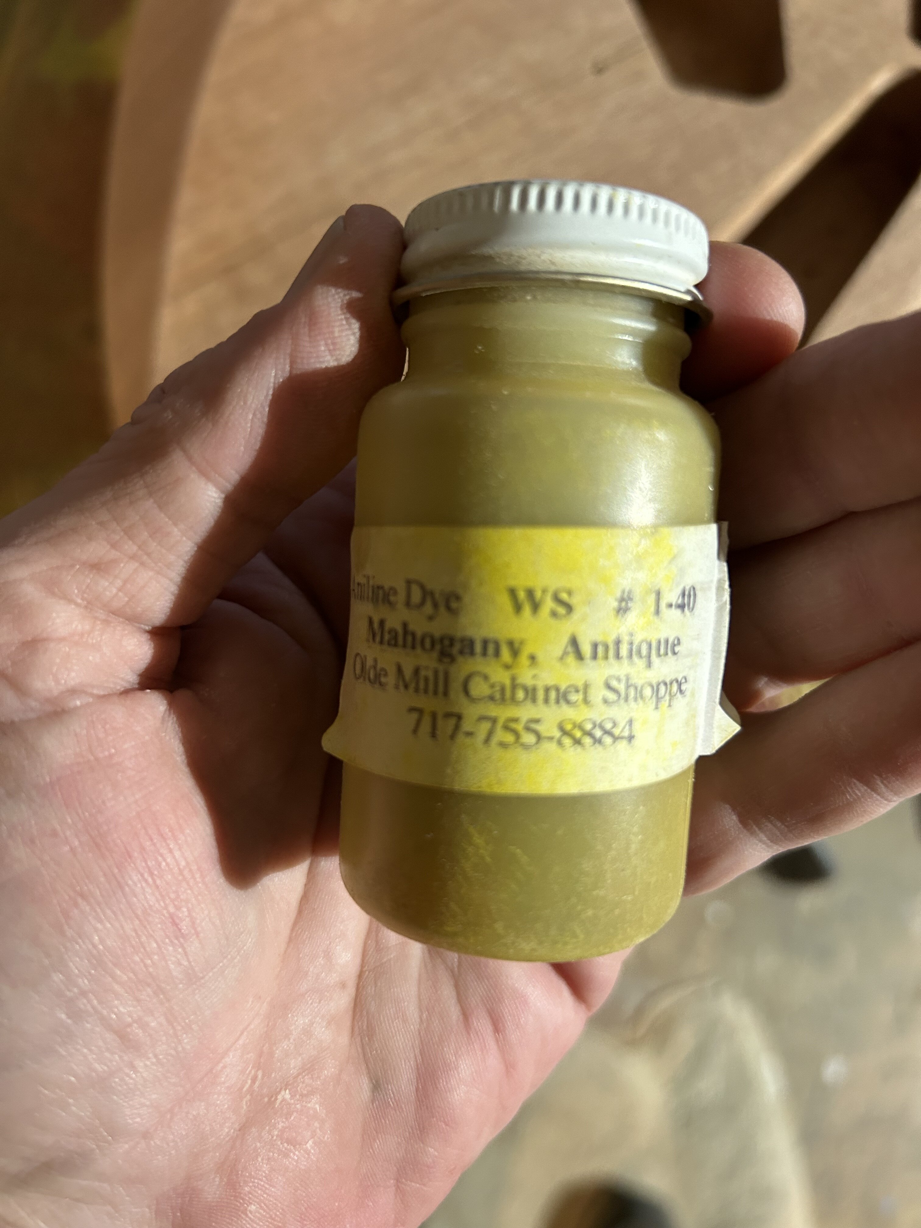

And my cleanest comfort carves to date, I would say. And I located the aniline dye I wanted. I’ll dissolve the powder in alcohol then mix it into some shellac, which will become my color coat. Then probably gloss lacquer over that.
And my cleanest comfort carves to date, I would say. And I located the aniline dye I wanted. I’ll dissolve the powder in alcohol then mix it into some shellac, which will become my color coat. Then probably gloss lacquer over that.View attachment 92142View attachment 92143View attachment 92144
