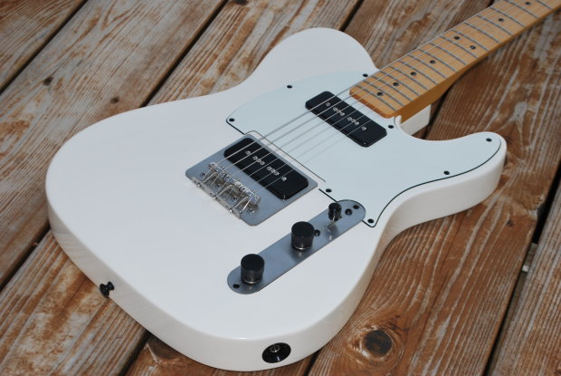

A Tele shaped guitar with 2 P90's. I should have been more clear.

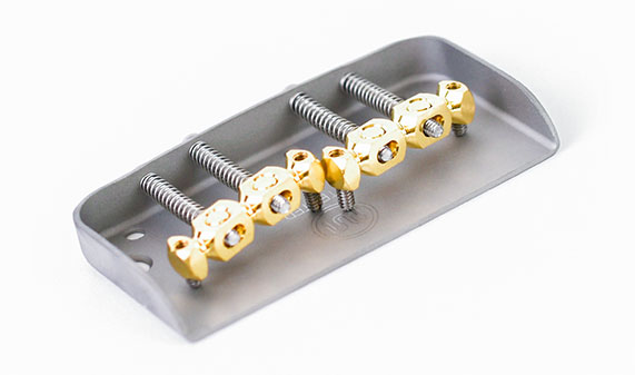

Were I building such a beast, I'd prb go with a wilkinson compensated half bridge, like the one Guitarfetish has on their site

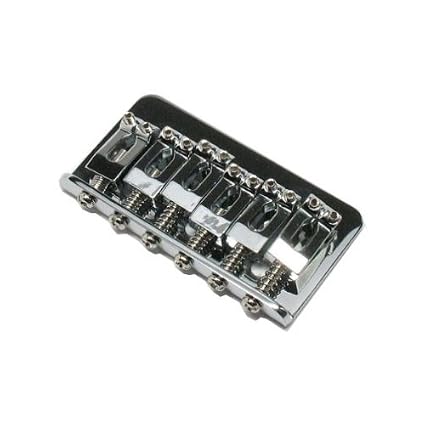

P-90 cover is wider than the Tele bridge-plate. I would go with a half Tele bridge, like above, or just use the Fender hardtail bridge, which is what Fender used in this case ...
