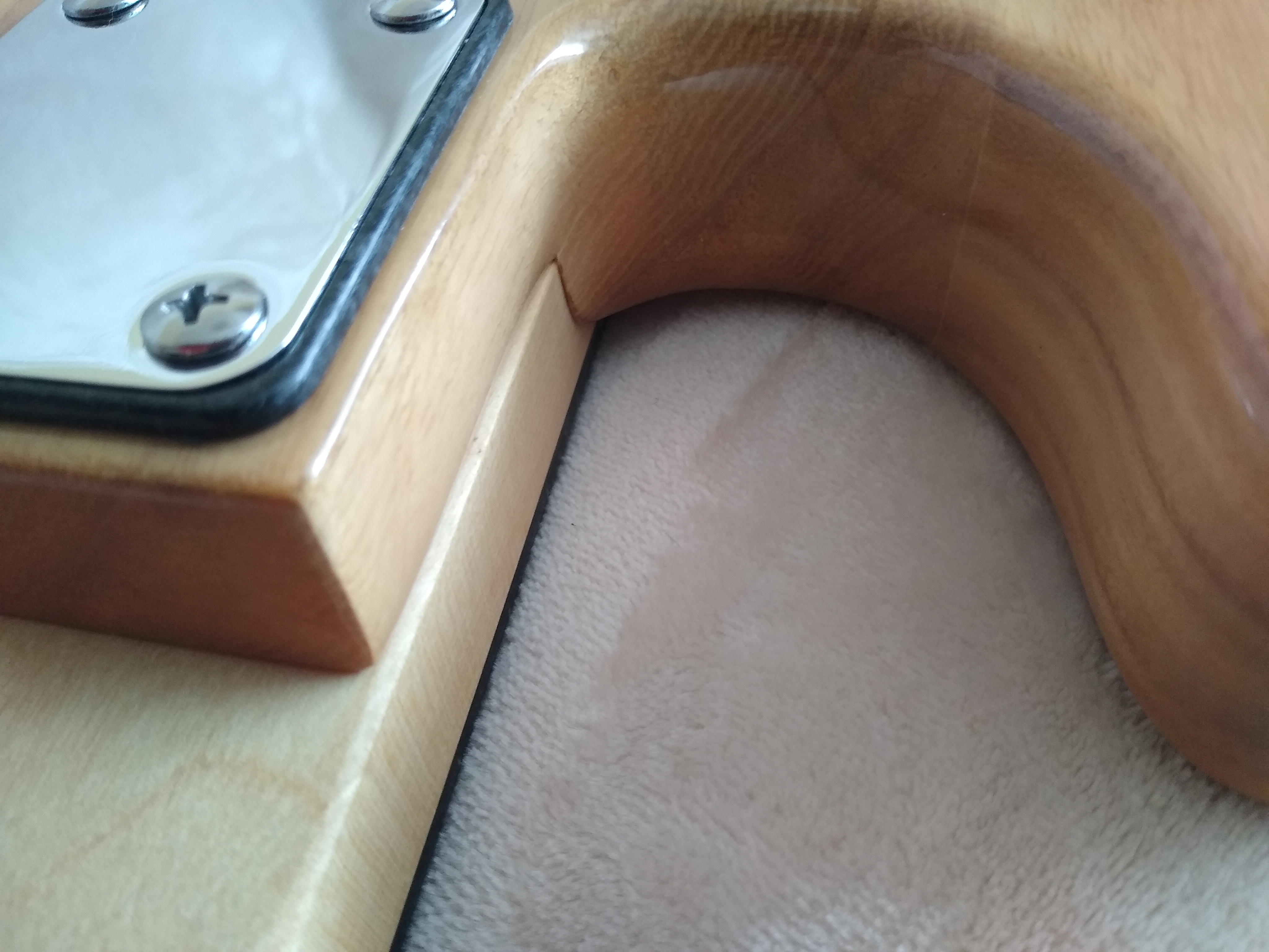

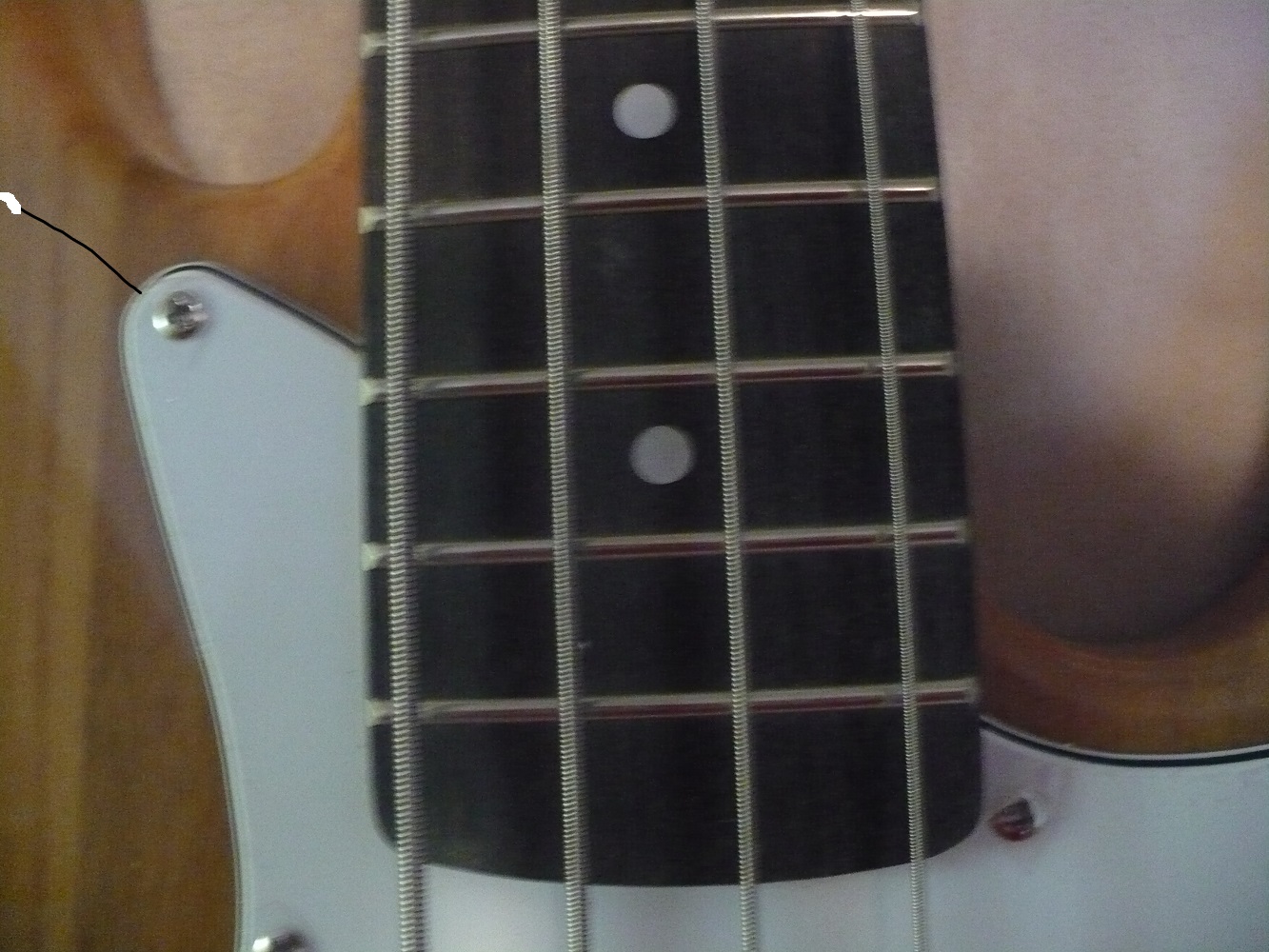

I can understand why you'd send it back, but there may be enough play in the neck pocket to align it...

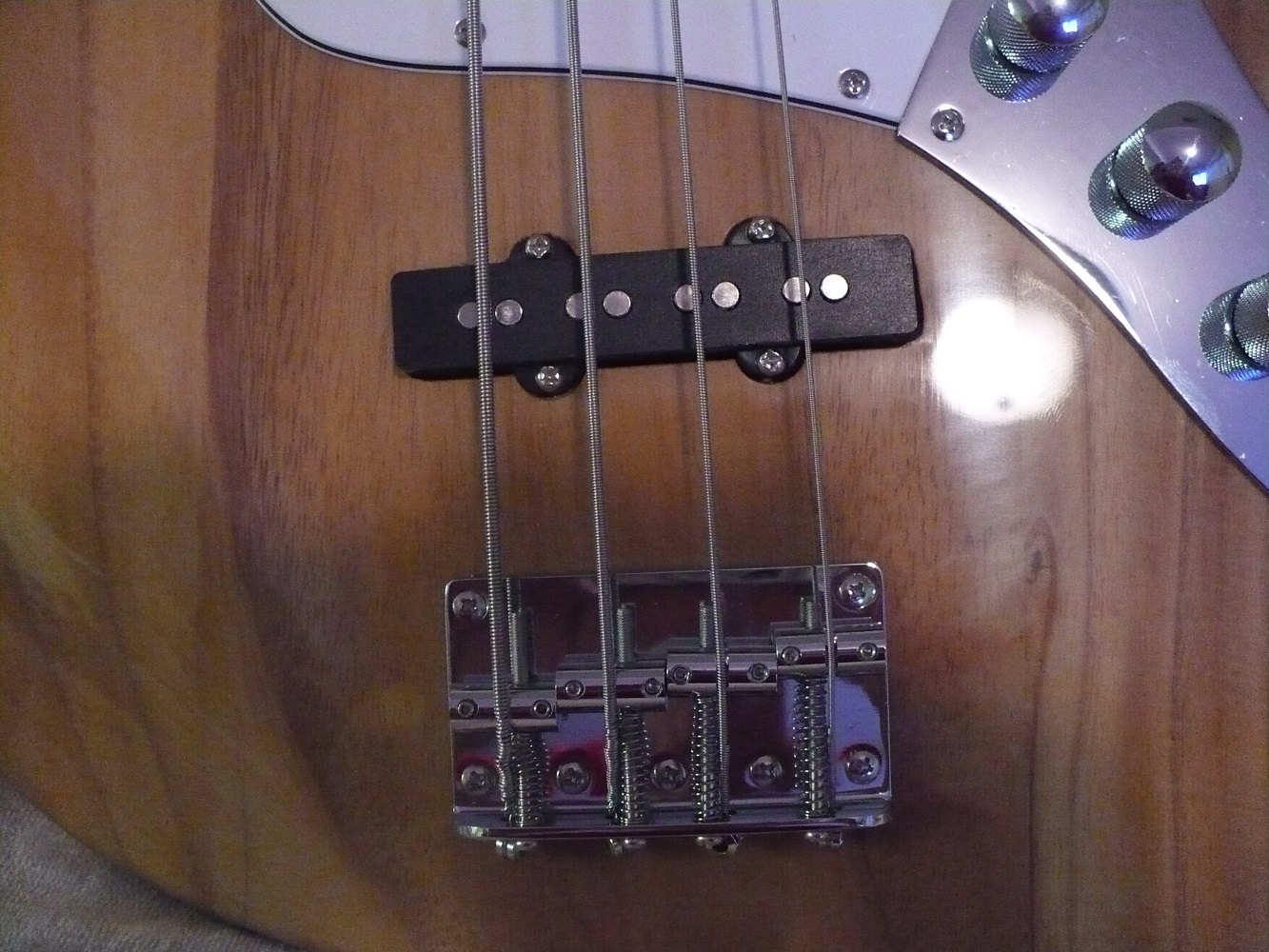

I think the neck pocket is where the trouble started and everything else is from that. If it was deeper into the side of the body, that would help slot. Don't know if you can tell from pic but bridge is cocked, spun counterclockwise.
I think the neck pocket is where the trouble started and everything else is from that. If it was deeper into the side of the body, that would help slot. Don't know if you can tell from pic but bridge is cocked, spun counterclockwise.View attachment 50778
The bridge twist is easily overcome with the intonation adjustments, but the neck pocket being misaligned not so much...if you really wanted to keep it you could pull the neck and file the pocket until it moved the neck into position, but it's probably not worth the effort...
