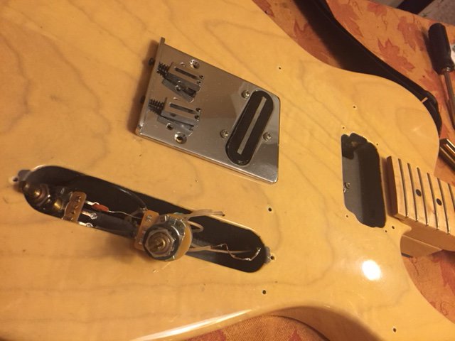

First, get the strings off. Clean the pickguard and bridge:

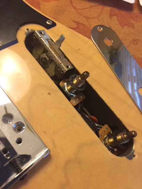

Since I was going to be rewiring anyway, I decided to try a reversed control plate layout, moving the switch to the bottom. Look how cruddy the switch became over time:
Rather than mess with old solder and crud, I had a brand-new 3-position switch to install:
By the beginning of November, I had the P-92 installed and the controls rewired.

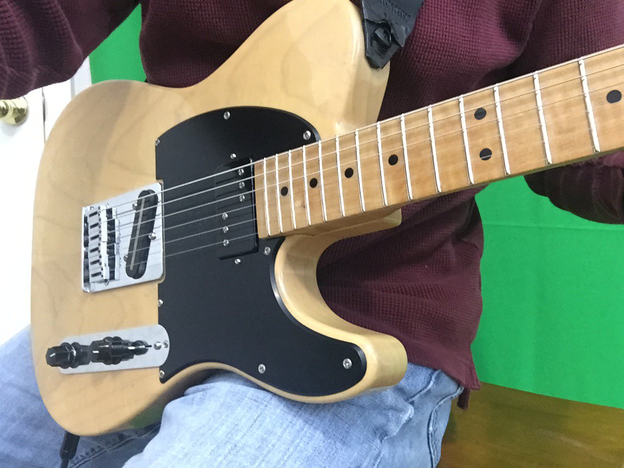

It is glorious.
Kerry is amazing. If you are anywhere close to Hurst, Texas, I can't recommend him highly enough. The guitar plays perfectly. My fingers hurt right now because I can't put it down.
