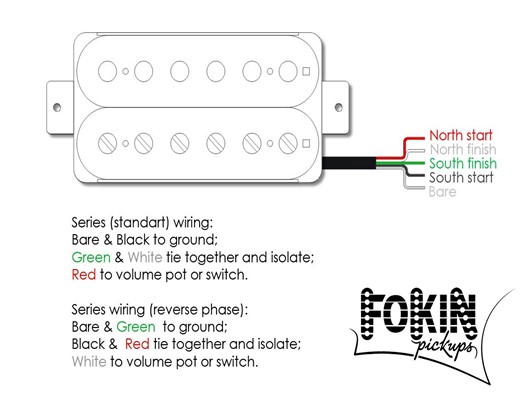

The wiring color diagrams are in Russian!!!
I think the website had an English version.

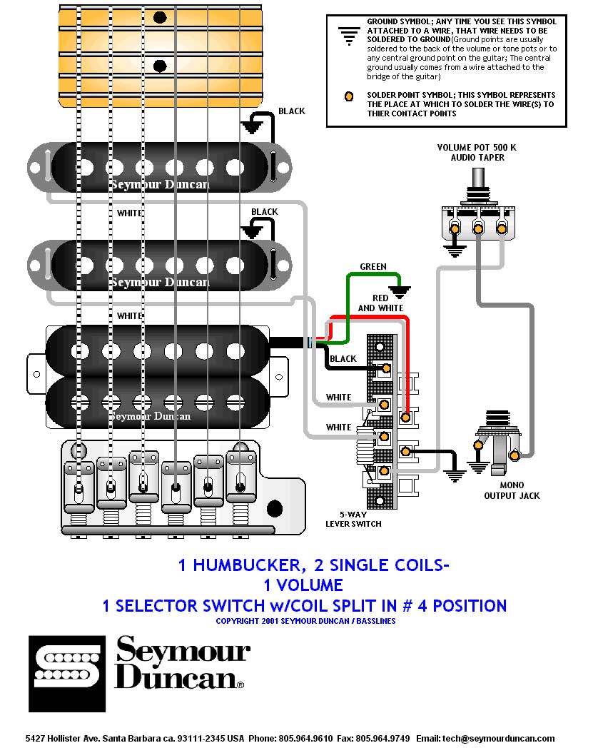

But if anyone had any tips on doing this....I'm all ears. I'm nervous I'm gonna F it up.
I figure ill do one pickup at a time and just follow the wiring already there.
I'm assuming that I want to do the soldering before I install the pups into the new pickguard?
