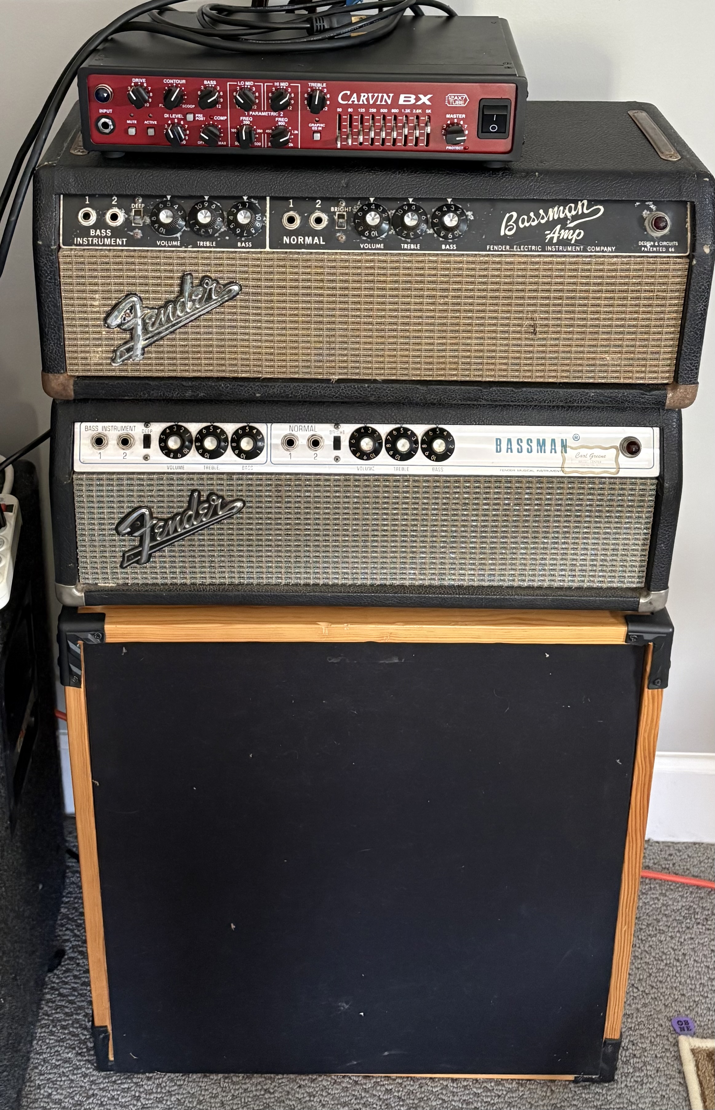

My techs completely went thru the amp and replaced all the caps and repaired as needed. Put on a grounded 3 prong and installed a bias adjustment pot. He's still chasing a bit of noise when the vol is maxed on the bass channel, but other than that it's good to go. He's using tubes he had laying around and wanted to know if I wanted to go with those or order new ones. I told him to go ahead and order me a fresh set of matched tubes all around and meanwhile keep chasing that last bit of noise.
So I have a matched pair of Tungsol 5881s and some fresh JJ preamp tubes on the way and it looks like I'll be getting the head back soon.
So now I gotta make a decision on a cab and speaker(s). I could build something but I want it to match and not look homemade.
At this point Im thinking a Mojotone 1x12" open back in matching tolex and aged cloth, and a 4ohm 80w Weber Chicago 12" for a reasonably small footprint so I can actually gig the thing. But I do have a Marshall 2x12 cab I could load up with a couple 8ohm speakers for a 4 ohm cab if the head fits on top. It would be more bulky to haul but would prob sound great and would be a cheaper option.
So I got the head back all good to go. It sounds good but the new preamp tube in ch 1 is microphonic and I need to take it back for a replacement. . Ch 2 sounds great.
Now I gotta decide on speaker options. Plugged it into my homemade 1-15 Weber Cali but did not care for the sound. Too much bass, too much treble, just too much of everything and too bright and in your face. Whatever I decide to get it needs to be a lower efficiency speaker(s) than this jbl based Weber Cali. Funny the Cali sounds great w the Silverface Bassman but too shrill and bassy at the same time with this one.
I’m thinking for convenience a wide enough 1x12, but a diagonal 2x10 config is tempting.
My options are:
1. Build another cab. Most cost effective but I’ve gotten real lazy and not as keen on projects these days.
2. Order a cab. Gonna cost 300-400 min for the empty box unless I find something cheaper used.
3. Use something I already have. Marshall closed back vertical 2x12 that head just fits on hanging off only about 1/2 in on both sides. Looks ok and it’s stable, but really more cab than I wanna gig with. It’s 8 ohm and speakers are shitty 70/80s so I’d need to convert it to 4 ohm w better speakers.
Looking at different speaker options by Weber and WGS. Im in no hurry it’s not like I really needed this thing.
Would be interested in any ideas re speakers and cab.
My options are:
I use my old combo amp as a cab for the Valve Jr head. . . definitely not ideal, but the price was right. Even if you end up replacing the speaker, picking up a pawn shop special just to use for the box would be way more cost effective than ordering a new cab.
My tech has an old no name appropriate sized 1-15 cab he offered to give me. Open back and already has casters on it. But I don’t really want another 1-15. Problem w used, esp 1-12 config is finding one wide enough. It’s a big ol head. Most 2-10s or 2-12s are horizontal and closed back which I don’t really want. Ideally I’d like a 2-10 open back in a diagonal configuration.
