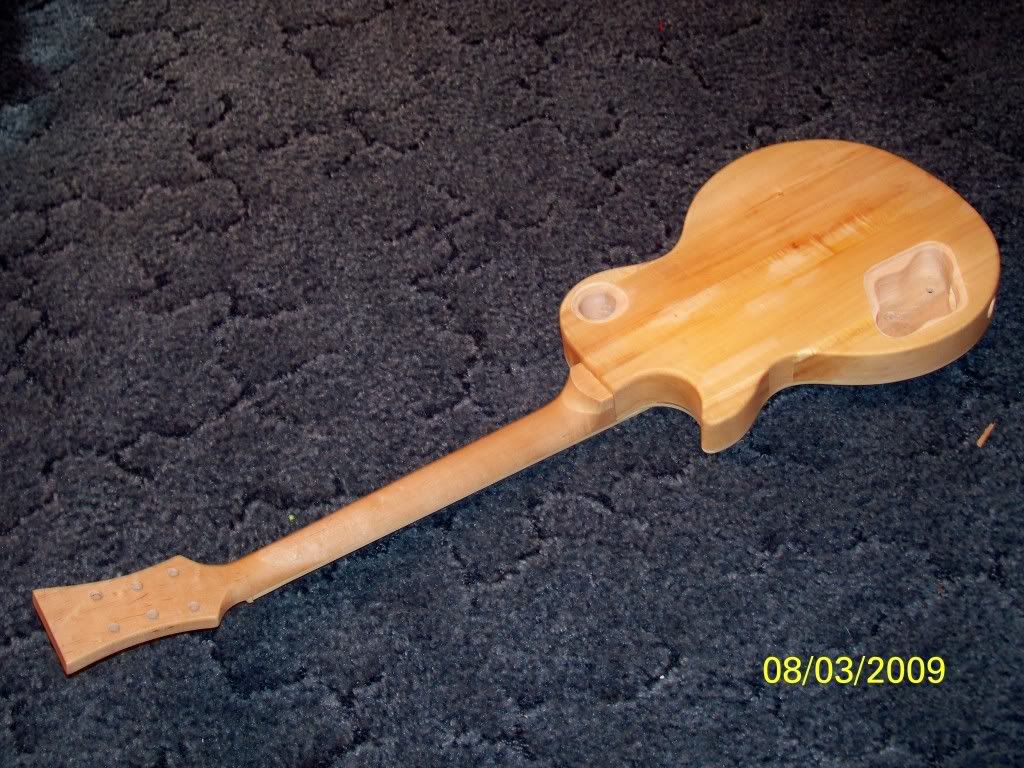

When the kit came to the house...

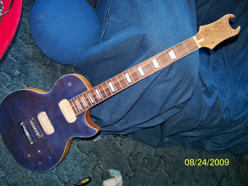

The name of this guitar is purple passion and I started it with a hard dose of blue dye from stew mac.
Then I mixed some purple and might have hit it with some red too...can't remember if I did plain red or a very reddish purple and then a real purple:facepalm:
This was about the color from front to back that I was going for

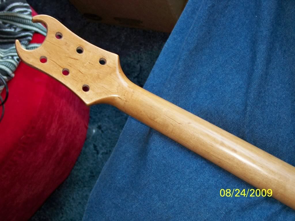

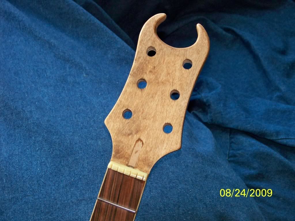

Zemmy wanted horns for the headstock, which was good practice for cutting a nice shape for someone that I had to do from scratch with no templates or designs before hand
I wanted as close to a raw neck on this as possible and sanded back alot of the stain and tung oiled it, the stain is all minwax and the last color ended up being the darkest stain that I could get and alot of the inbetween stages are mixed up from different stains. The clear, once we get there, is Deft Nitro.

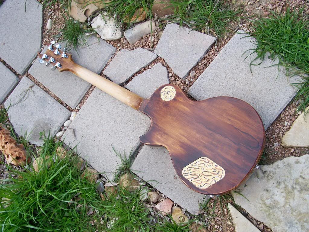

This is where the back took a new direction. I wanted something that looked like old wood, not relic'd so much as old. This took some messing with, but I looooovvvveee the way it came out.

I did a henna tattoo like cover design to make the cheap plastic covers look like something more fitting.
