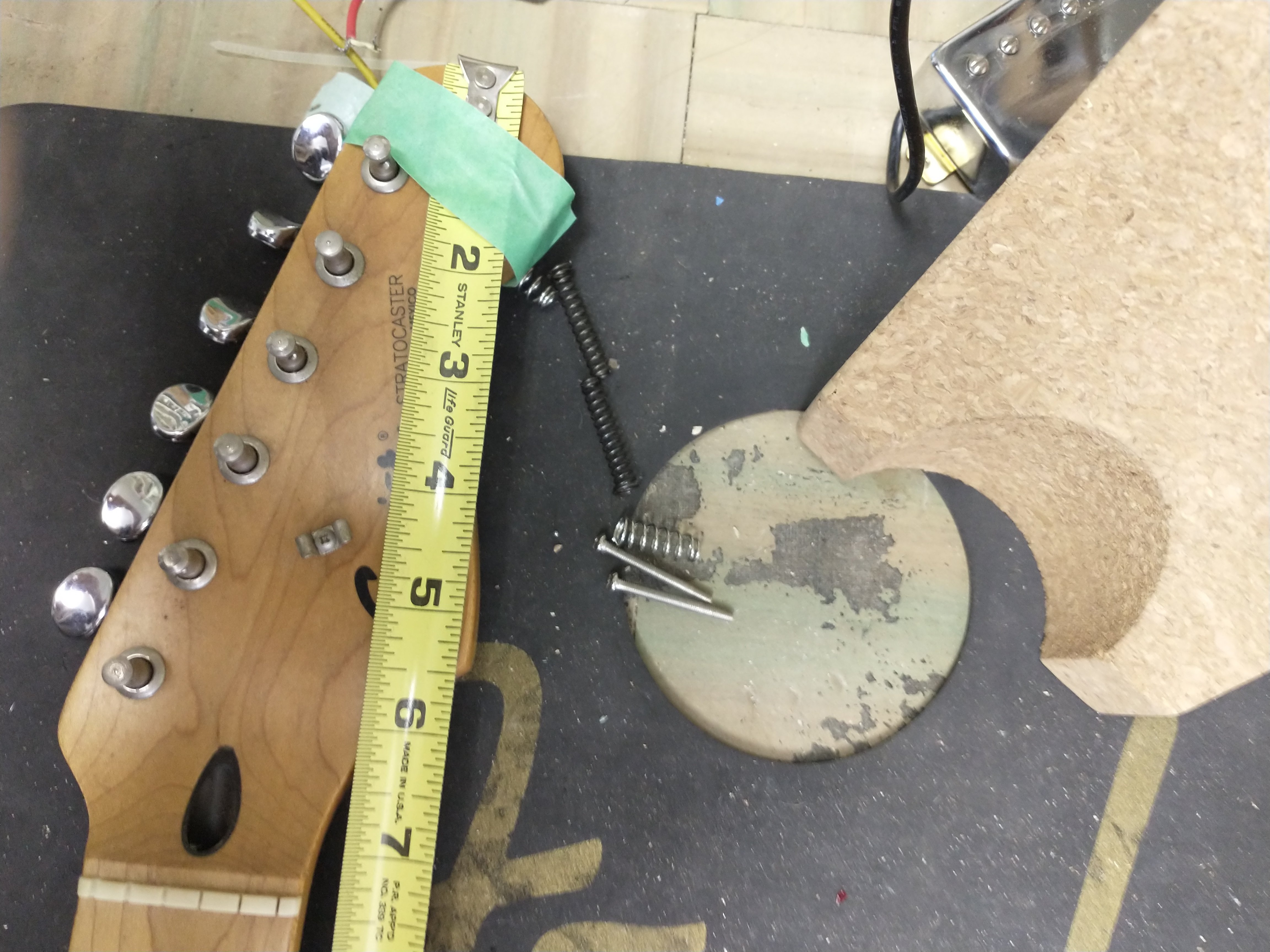

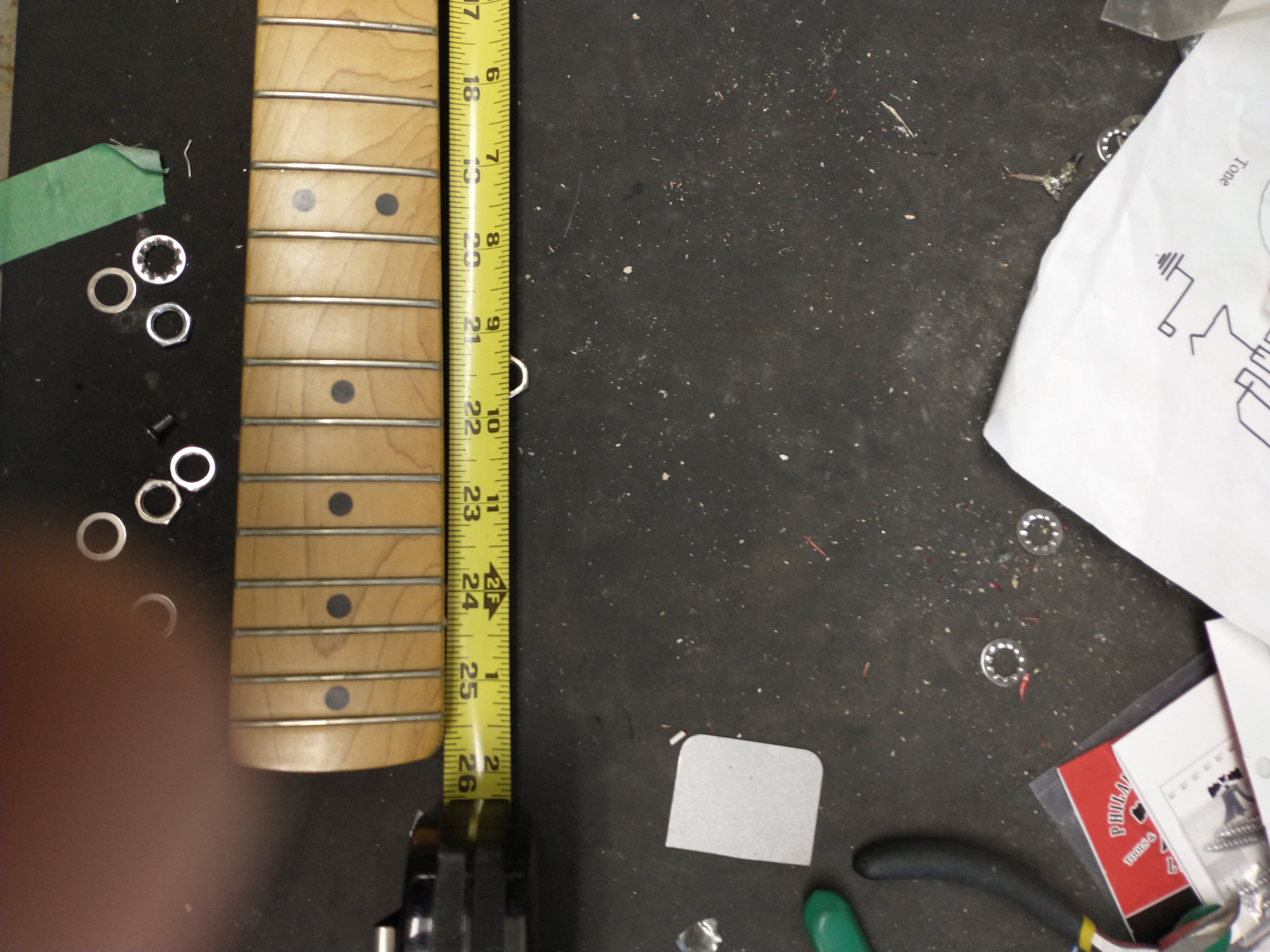

ordered a fret puller. Anybody have an unmounted strat neck handy? This is 22 frets, no overhang. From bottom of nut to bottom of heal 18". To 21st fret 17 3/8"

So, the most useless/won't miss it/won't feel bad about butchering neck is this one. It has 22 frets, no overhang. From bottom of nut to bottom of heal 18". To 21st fret 17 3/8". I was just wondering how off it would be scale length wise.

I'll go down and get length measurements in a few minutes. I'm trying to avoid shovelling snow. It's damn cold out there today.
Ok. 25 3/4-7 1/2=18 1/4. I measured com nut to 12th, doubled and came up a quarter shy of Gibson scale. So, that makes sense my neck,18", is 1/4 shy of strat. Close enough. Thank you.

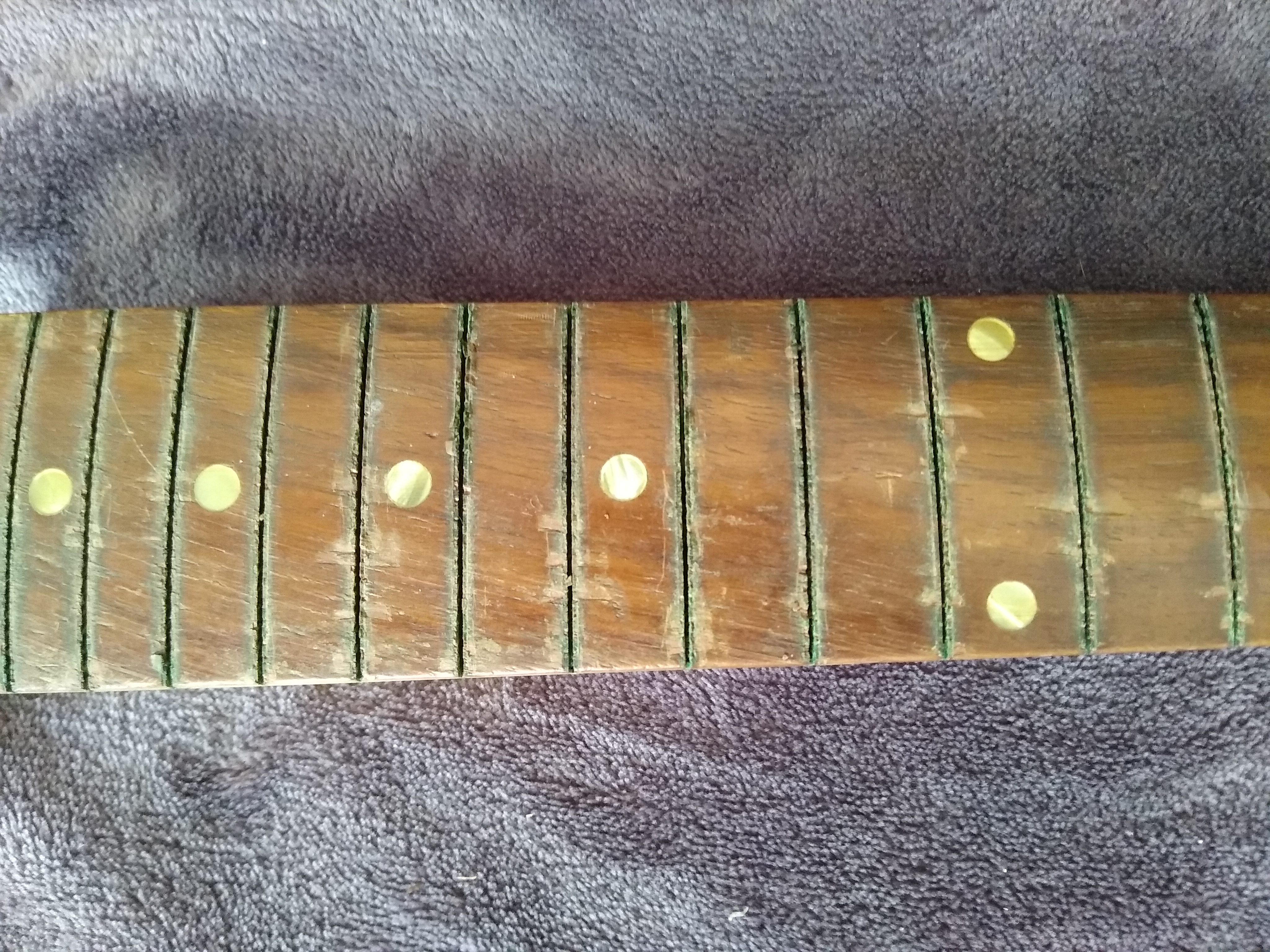

Fret puller arrived. Note to self- never try this again. At least not on something of any value. Probably should throw fret puller out so I won't be tempted.
Bit of felt or similar would have saved the fretboard.
I digress, bit of polyfilla in there, quick sand and you're golden.:embarrassed:
Already sanded it, there were ridges of crud. Feels a lot better.

Fret puller arrived. Note to self- never try this again. At least not on something of any value. Probably should throw fret puller out so I won't be tempted.View attachment 64498
Typical MO for pulling frets is to use a soldering iron to heat the individual fret wire, to a point, allowing the metal to slightly expand, then cool a bit, then GENTLY pull the fret.
The jaws of the fret puller can easily dig into the fingerboard so, exercising caution is advised.

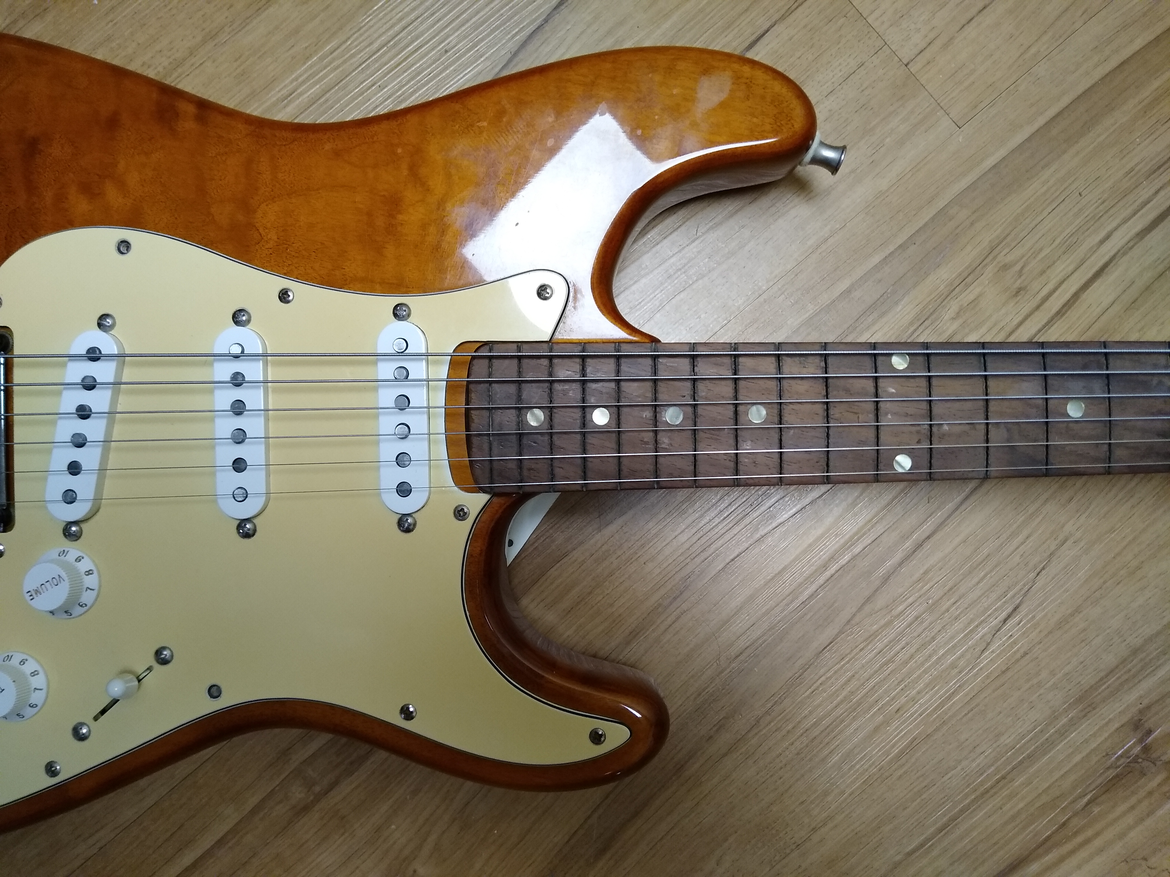

Yes, I know, big gap in pickguard. Yes, I know bottom of neck is wrong shape. If it was correct shape, scale would b even shorter.
