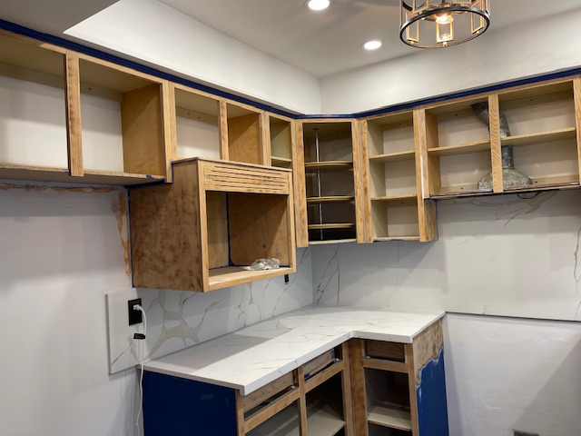

So the countertop and backsplash… We were happy with that.
Until.
We noticed that the overhang of the countertop will interfere with the lower doors and drawers.
When they installed it all, they didn’t shim the cabinet tops to allow for the necessary clearance.
The drawers barely slip under. But the drawer fronts are not yet installed.
The cabinet door in the corner won’t clear at all.

The backsplash has to come off because it’s installed on top of the countertop.
Then the countertop has to come off.
Shims need to be added to the cabinets and the countertop reinstalled.
Then the backsplash needs to go ba….oh wait. Now the backsplash is too tall. The top needs to be trimmed in order to fit under the cabinets.
Wait again. Now the outlets and switches don’t line up. So, they need to be moved up to match the holes in the backsplash.
I sure hope the backsplash or countertop material doesn’t break in all of this.

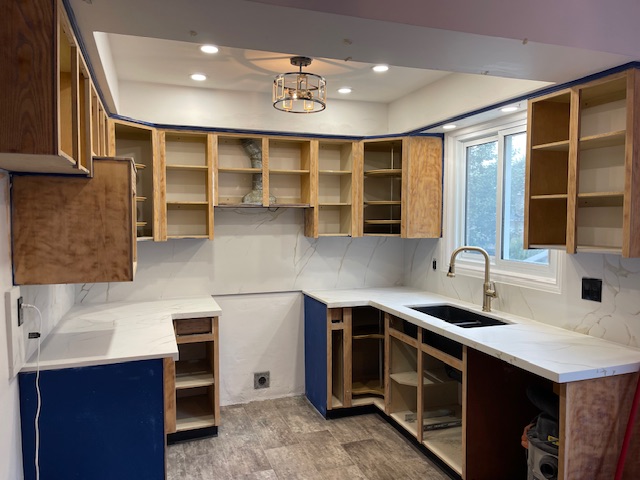

Yeah. In reality, we’re looking at just gutting the room and getting new cabinets and everything else.
Hey, at least it’s only been 2 months for a 10 day job.
As it sits.
All the stuff that was contracted is fine.
Counter and backsplash are good. Although the backsplash is just as thick as the counter, it’s really only an issue behind the fridge where that outlet is in the pic and it might not be that bad.
Lights and sink/faucet are great.
Anything paint is a gong show. Except for the window trim and sash.
Anything to do with managing the project seemed to be out of order.
That cove where the lighting is: was just sanded and primed today for the first time.

Shims? More like at least 3/4" plywood.
I can't imagine removing the backsplash or, counter tops in one piece but, if you could, why wouldn't you trim the bottom instead of the top?
Is taking the fronts off the drawers and moving them down a bit and option?
Might be a pita but surely less hassle than plan A?

That’s been looked at. The drawer fronts would need to be flush with the top edge drawer box and that would look goofy on its own.
That would also require all of the lower cabinet doors to shift down to maintain the spacing, and that would put the bottom edge of the doors below the bottom edge of the cabinet carcase.
There’s one cabinet door that goes all the way to the top - no drawer above it. That one just hits the overhang. No wiggle room unless we drop it down a bit. Then not only would that hang below the bottom edge of the cabinet, it would just about show the cabinet opening at the top.
Even if that worked out, some spot are so close that the drawer tops scrape along the bottom of the overhang.
