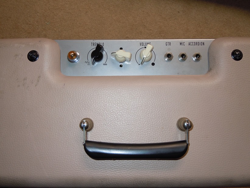

After getting one, the thoughts of mods start going through your head. The interesting part about it is that mods for me are not really to rebuild and amp but more to improve the sound or tone without much modification. After exploration I have come upon several mods that can be done on the amp.
1) Speaker Upgrade
This upgrade is mostly for the initial release of the Excelsior. Replace the speaker with a Eminence Legend 1518 Speaker to improve output volume and improve bottom end.
http://www.eminence.com/speakers/speaker-detail/?model=Legend_1518
*Just a note: The Excelsior Pro has the Eminence Legend relabled with a Fender sticker
Also available is a 15" Weber Vintage Chicago OEM type speaker, based on a 1959 Jensen.
https://taweber.powweb.com/weber/15f150a.htm
2) Tubes
Excelsior come with tubes made in China - you be the judge. From what I have read, some models come with Groove Tubes.
3) Tone Control mod
The stock Excelsior's tone is a switch and your choices are "Bright" and "Deep". Replacing the 470K resistor with a 500K Pot should give the control the sweep point from end to end. The cap values can be changed as well if needed.
4) Tremolo Mod
Resistor components can be changed to increase the speed as well as an insulated jack installed for a remote switch.
5) Output Transformer mod
The TO20 from my readings is the tranny to replace in this unit. It is a custom would Heyboer transformer for Allen Amps and is really for a Blues Junior upgrade.
http://billmaudio.com/wp/?page_id=545
If you are interested in hearing or reading about some of these mods, Bill M makes kits that you can purchase from him if needed. Bill also has mods for Fender Blues Jr's and Princeton Reverb.
